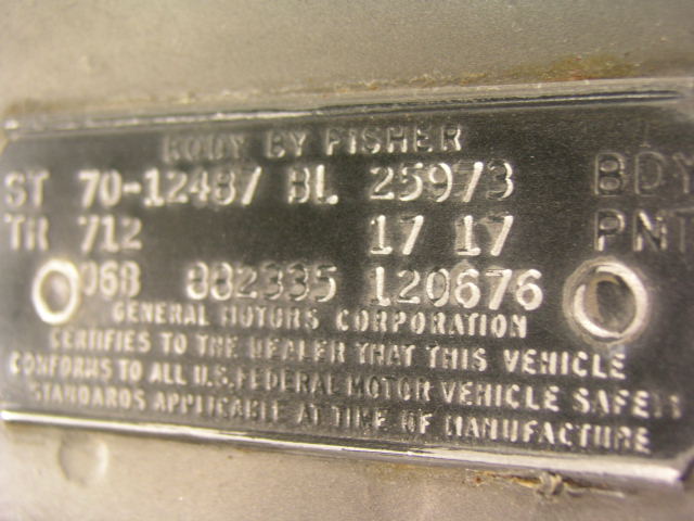

where is the hidden VIN on the tail-light panel? on the subframe? I know there's one on the firewall behind the heater box...where else? Thank you in advance

Attachments - The Supercar Registry 327701-P1010004.JPG 327700-P1010007.JPG 327699-P1010005.JPG 327627-P1010004.JPG

The 70+ Camaros had ONE vin stamp on the firewall as youve mentioned. The 2nd Gen enthusiasts at www.nastyz28.com have never seen evidence of any other body/frame VIN stamping.
There is of course the VIN tag riveted into the dash area
The VIN's were also stamped on the Z-28 and 402 Blocks and Transmissions.

My 70 Z has two on the firewall. One was near the heater core and the other at the lower part of the firewall near the tunnel on the passenger side.
It is impossible to certify a COPO or Z/28 as authentic without verifying that it is not a rebody...
That's not true. I recall seeing posts about the subframe VIN on NastyZ28.com. I then looked at my subframe to see if I could find one and I did. Unless I was dreaming it. I'll take a look when I get home.

A member here had a very low mileage 70 Z that had a picture of the front sub frame with the VIN number stamped on it. The stamp was facing the outside underneath the drivers door. I looked on mine (not very carefully mind you) and could not find any stamp on the front subframe.

It was Kenny Pascoe's 3500 mile Z that I saw the VIN stamped on the front subframe.

That's interesting...You learn something new everyday...I will check my subframe tomorrow for a VIN on the subframe...anyone got a pic. where it might be exactly??? I just finally located the VIN on the block after owning this car for maybe 20 years or so....

PM K Pascoe (member here). He may still have the picture of the VIN stamped on the front subframe.
