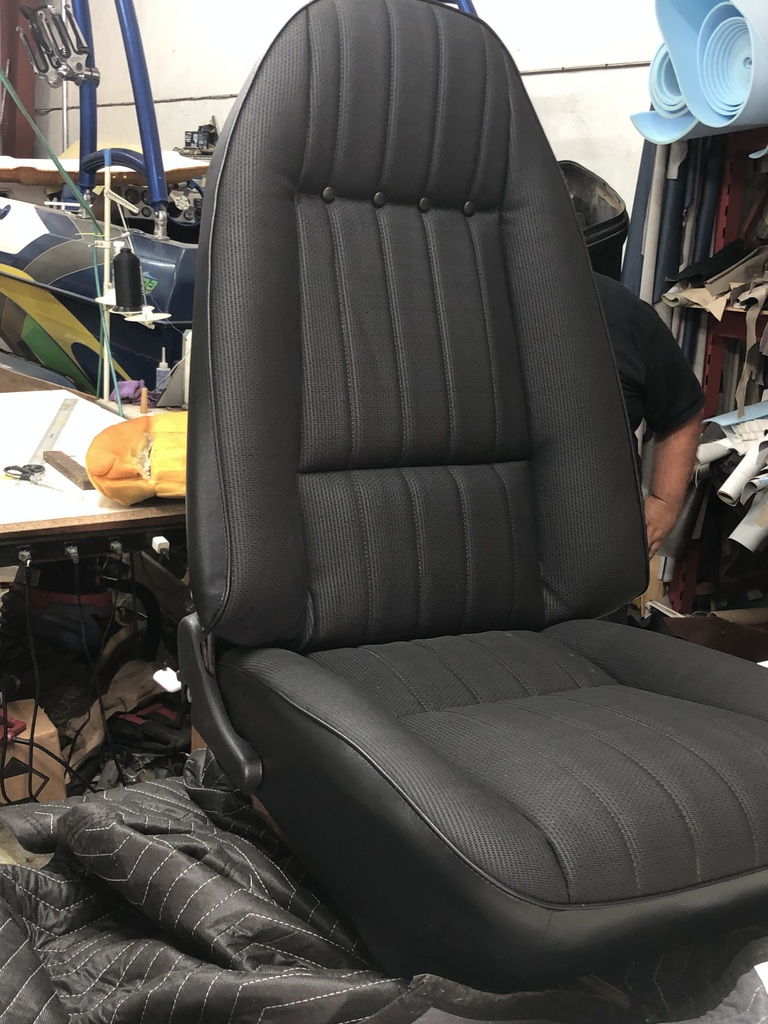

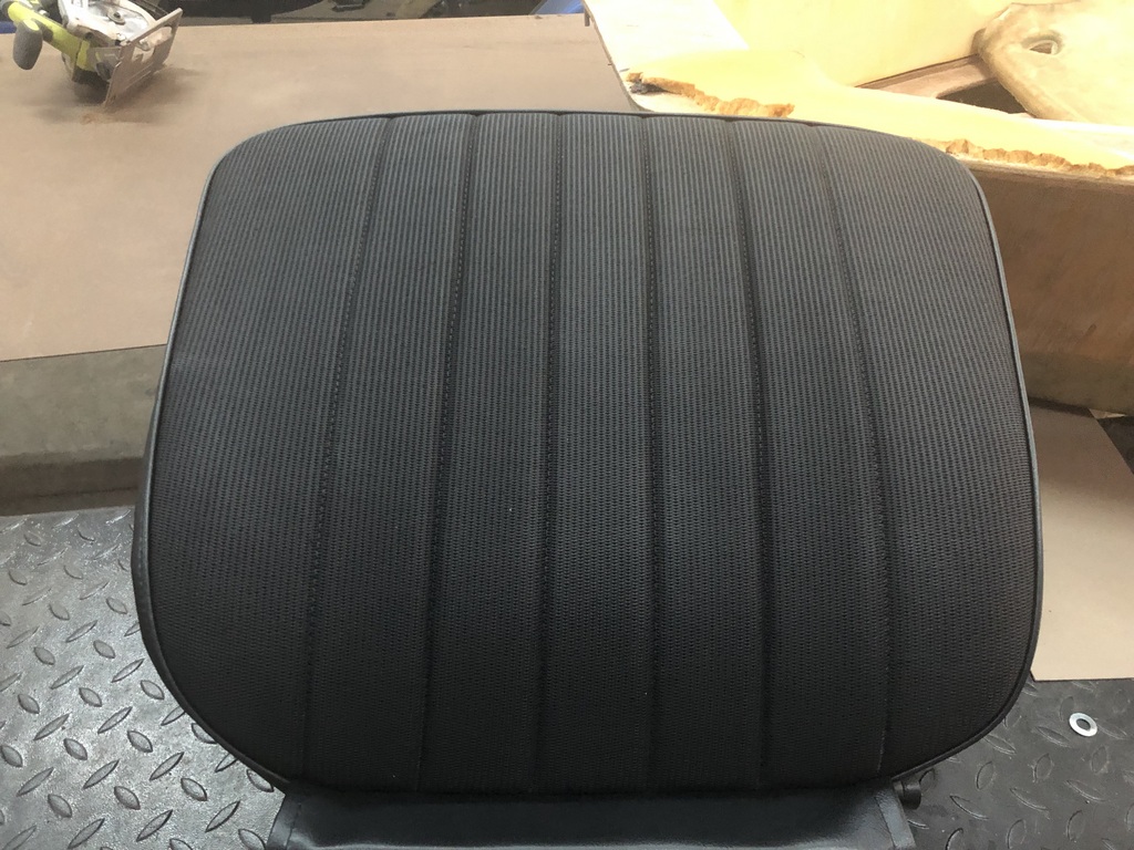

Great info James! I have been dreading getting anything on my seats because they look like they will hold on to everything that touches them.
These are my 73 Camaro Z28 seats that my upholster made from NOS comfortweave. The NOS material is very coarse to the touch.
Is the NOS material different than the original? I have a couple of yards coming to redo my drivers and rear seat back. The passenger seat is perfect, 0 wear or stains. Is there even a chance of a match? I don't mind a little off, just don't want it to be extreme.

Originally Posted by BCreekDave View Post
Is the NOS material different than the original?.
It looks exactly like my my 46 year old seats, just has a very aggressive grip to it. I think a few times sitting and sliding on the seats will knock it down pretty quick.
