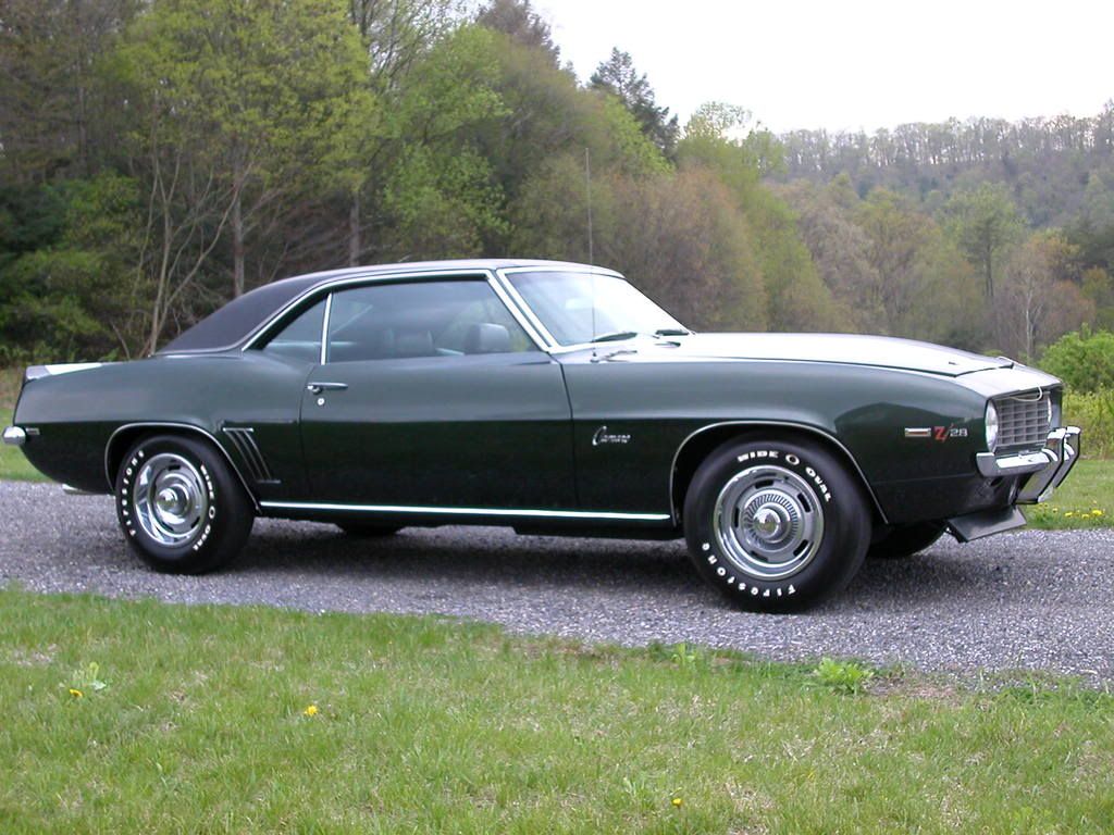

John, What car did you buy? Any pictures? Sam

http://i708.photobucket.com/albums/w...7/DSCN2120.jpg

Judging by the hood, it's a cross ram. My vote, Too fat!
Excess fuel gets in the exhaust, A.I.R. does its job, wham...backfire! M.O.O. and $0.02

NIZZZE car John!
