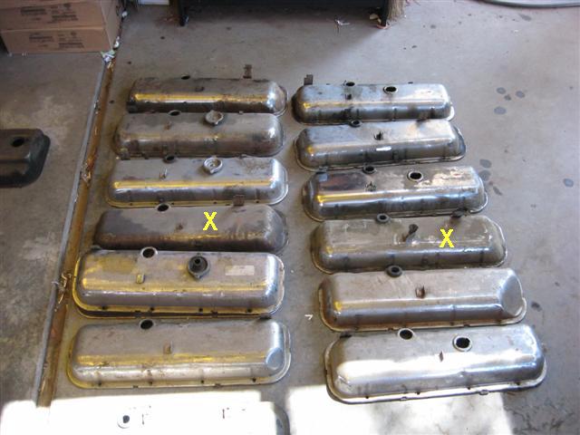

Does anybody know if there is a website that shows the applications of different BBC valve covers? I have a bunch of old chrome dripper valve covers and would like to ID them. Crane Corvettes used to have pictures of many of them but the pictures have been pulled. I plan to sell the covers and do not want to misrepresent them.

Here is what I am up against:

Jason, the third one from the bottom on the right side sure looks like a 69 Driver's side for Chevelles. It seems to have the correct slant at the back. Does that one have a little wire clip near the middle on the lower side facing what would be the driver's fender?

Top pair, left, might be 67-69 Camaro, 68-69 Nova. Any wire clips? and need an image of the end nearest the firewall of the one on top.
Top pair, right, second down looks like it might be 69 Camaro/Nova. It has the wire clip on the driver's side lower edge. Is that all the clips? Need a better image of the end nearest the firewall. Martin

I will snap some pictures tomorrow while cleaning them. Dan, not showing off, I just don't like to be an ignorant seller. Also, if a member needs a pair I would like to give them first shot. I know you were just poking fun.

OK, I gave the covers a quick cleaning and took some pictures. I tried my best to pair the covers up properly. These covers were boxed all together so I was not sure which went with eachother. I was able to pair a few from gaskets, etc. I really just used my best judgement on the rest. Pictures coming.
