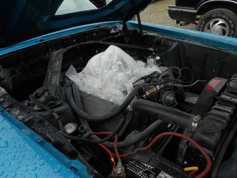

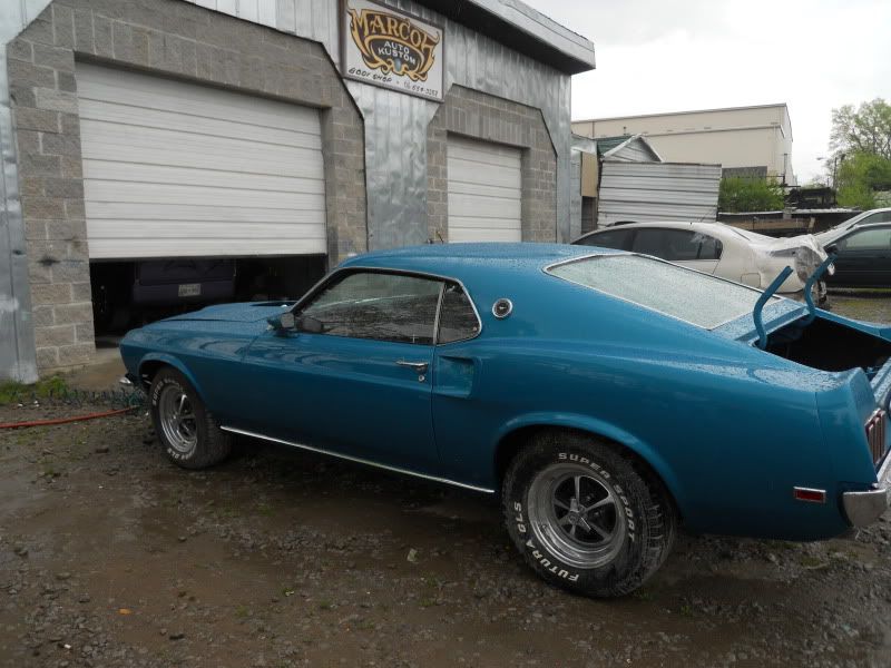

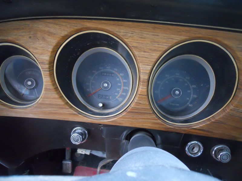

not the greatest pictures. he plans to jack it up over the weekend and look for the numbers. Like I said, I dont know fords, and looking at the 8K tach, there is no redline like mopars and GM. that is very odd to me. yet red line on the speedo after 70mph. What was ford thinking? be careful speeding but go ahead and blow up your engine (without a redline tach)?

I bought one of those back in '70...paid $2500 for and sold it in '74 for $2500. You're right there is no red line on the tach but one on the speedo @ 70 mph. Good score if 'it is what it is' and the numbers match. They are great cars but hard as hell to parallel park without power steering. The rim blow (horn) steering wheel advertises your parking prowess....that's a big lump between the fenders...headers are another challenge.
