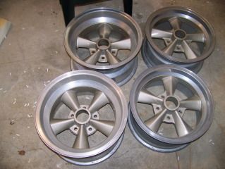

They should work fine with a single piston 69 Caliper. <span style="font-weight: bold">If I am wrong someone please correct me.</span> They will not clear the big 68 and ealier 4 piston caliper without a spacer. The 15-7 wheels have a deep backspace so a spacer is not such a bad alternative if you have the big calipers. I also have a spare 15-7 that I could send out if anyone is interested in test fitting.
I really do not have a use for these and plan on listing them on Ebay. Ebay and Paypal are going to take $150.00 away from me if they sell so new asking price is $925.00. If you can use them and $925.00 is too much make an offer. I also have 4 American 200S 15X7 for $500.00 and a pair of American 15 x 7 slot wheels for $250.00? I am trying to get rid of stuff I should have never bought in the first place so I can buy more stuff I don't need.

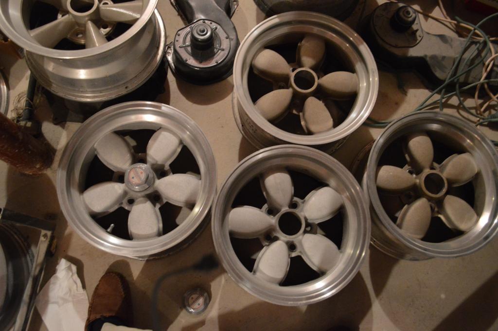

Bill do you have pics of the 200S Americans?

Sorry for the delayed reply. I have been away. These are a matching set but it looks like someone tried cleaning two which lightened the color on the spokes. No center caps. Have correct sand texture on the spokes.

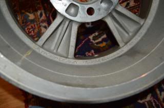

Backspace on the T70's are as follows 8.5's = 3 7/8 Backspace. 7's = 4 1/2 backspace. I have no idea if the 8.5's will work on the back of the Chevelle. The 7's should be OK on the front. I hope this helps.
