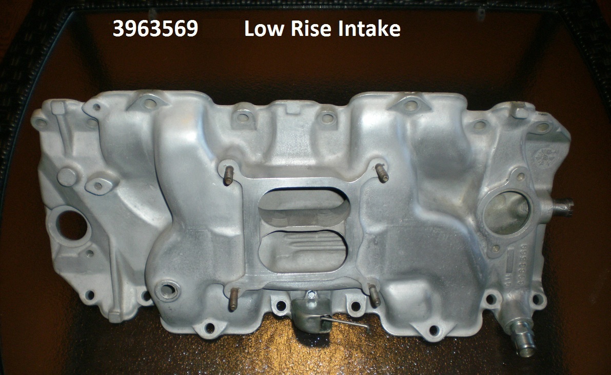

I have an LS6 569 intake and can't find a casting date on it. It may have come from a 1973 marine engine. Any enlightenment?

Does it have a riveted on oil splash guard underneath?

Yes,it has the riveted on steel shield.

Drill it out,there should be a date under there.

The Date code is under the shield. Here is a photo of mine before I put it on the engine.
I decided not to take the shield off mine to just check the date as I was confident it was original to my car anyways and did not want to re-rivet the shield back on. Once it's on the motor who will see the date anyways [img]<<GRAEMLIN_URL>>/biggthumpup.gif[/img]

The only issue with cleaning them is if you were to glass bead the intake -- trash may remain under the heat shield ... I have always (and very carefully) removed the rivets and and cleaned under the shield, then reassembled.

Sand blasting or glass beading without removing the shield is just inviting disaster. Sand is deadly to the whole engine.

Are the runners numbered on your manifold? If they are its 1971 and later.

No runner numbers and thanks for the help guys. It is appreciated.

If you do take the shield off and need new rivets, I have some that I will send you. They came straight from Chevrolet Engine Plant in Flint years ago.
