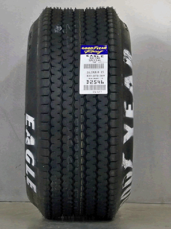

Looking to find out which new Torque Thrust wheels replicate the old ones along with what offset for a stock 69 Camaro? I like the ones with the lighter color gray in the middle vs. the darker ones. I would like to go with 15's along with a wider style bias ply tire. Wondering if a bias in a 60 profile would fit all the way around? Or maybe some folks have gone through this and can recommend a good beefy bias ply tire, 70's would be fine as well.

Will G60 15's fit all the way around on a 69 Camaro?

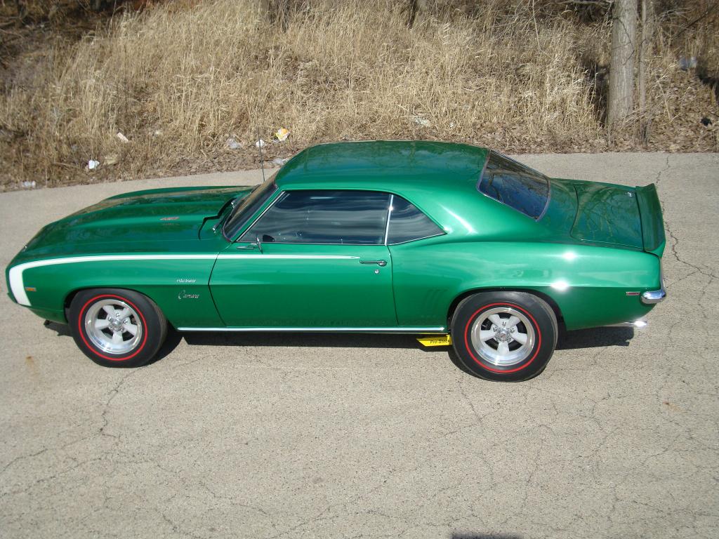

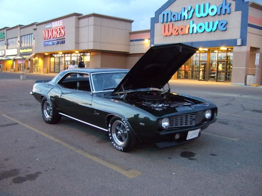

Here are some TTOs 15" x 7" in std offsets.
The Following 3 Users Say Thank You to Stefano For This Useful Post:
CanCOPO (08-24-2017), RPOLS3 (12-08-2022), x77-69z28 (08-24-2017)

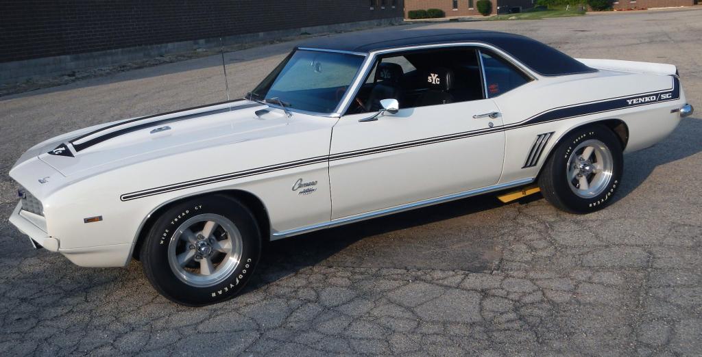

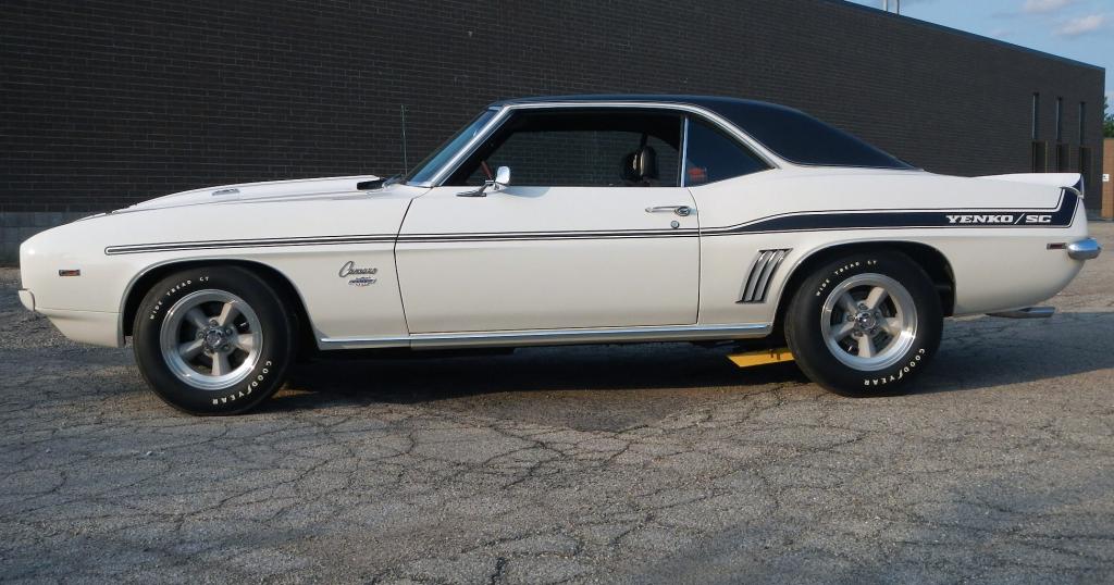

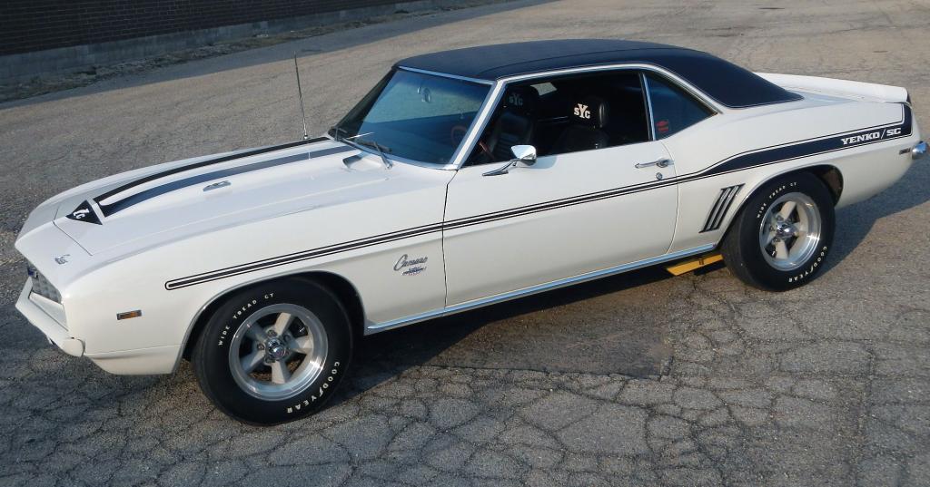

Douglass Yenko with same TTOs.
The Following User Says Thank You to Stefano For This Useful Post:
RPOLS3 (12-08-2022)

That is one good looking Rallye Green car Stefano. Is it your's? The white one, too.... Jack Douglas car? Not intending to hijack the thread, just giving credit when due.

The RG COPO is NicKey Continuation Carmaro #002. We sold it while back. The Jack Doulass Yenko is on consignment with us.

Wow! Now that is the look I am after!
Can someone tell me the part # for these or the offset? There seems to be a ton of sizes and offsets to choose from. So with 15x7's what is about the widest bias ply I can put at all 4 corners? My second choice would be to put something a little wider in the back like possibly an E60. First choice being the same size all the way around.
