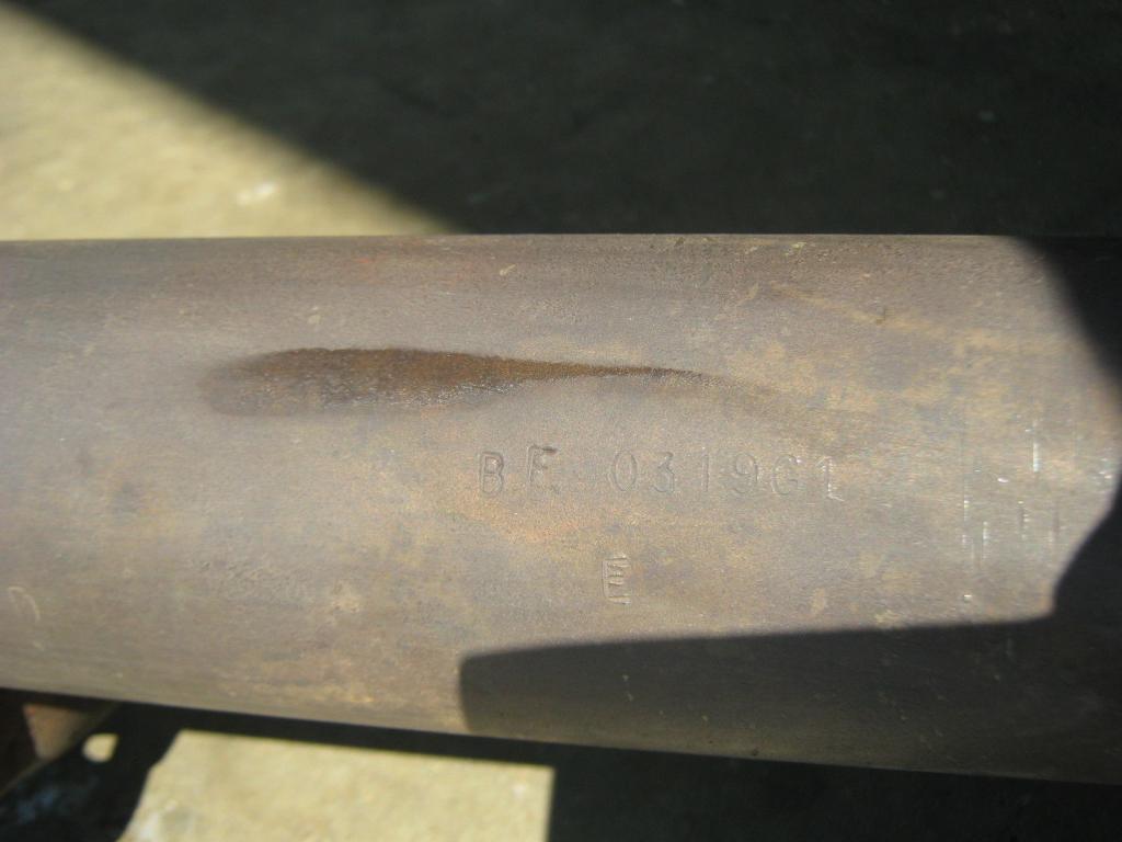

Be? auction
BE rear? or BE WARE ??

Date is good.

"Date is good."...... what are your thoughts about the top E ?? here is the same sellers old ID on ebay

That stamp looks really good to me.

It definitely doesnt look like a converted BL..

If seller a known restamper/crook, what are the chances all's genuine whether stampings look good and known date used or not??

I didn't know it was being offered by a known restamper, forger, and parts crook. Even a broken clock is right twice a day.
Thanks for the heads up.

&quot;If seller a known restamper/crook, what are the chances all's genuine whether stampings look good and known date used or not??&quot;

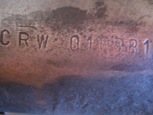

Here is a recent crw rear from the seller. Look good??
Ebay Auctions http://www.ebay.com/sch/427-king/m.h...=16&amp;_rdc=1

I did say &quot;if&quot; and was referring to what the above posted links imply.
Is there more to this story?[img]<<GRAEMLIN_URL>>/hmmm.gif[/img]

the top e does not match the lower, did they use the same character for the be stamp and the eaton stamp?
