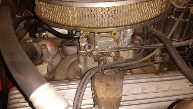

Hi everyone I am new to this forum. I am needing some advice and information on the 1969 Camaro z10. For the last several years I have been working for a gentleman maintaining his cars and motorcycles. He has a collection of about 30 cars and 15 motorcycles. Well he passed away recently and his wife has asked me to help her with the shop and to sell some of the cars. One of these cars is a 1969 z10. As far as I know everything is original except someone put headers, an Edelbrock intake and carb. on it. It has the wrong valve covers and wrong air cleaner. Other then that it is all pretty much original. I am wanting first is to find some pictures of a correct OEM engine bay. Before I put the car on the market I want to replace the engine components that are incorrect. I am also wanting to find online someone to appraise the car. Also if any of you happen have any OEM parts I need I will buy theme. Here are a few photos of the car.

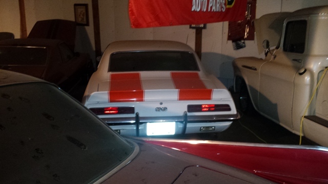

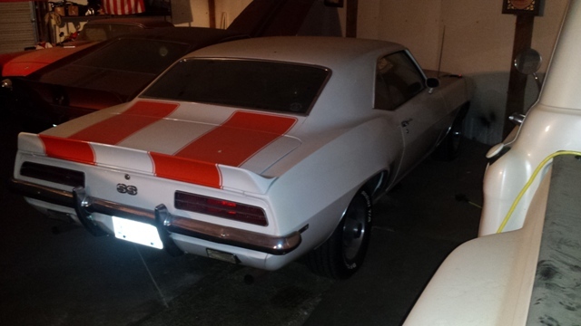

It’s had at least some restoration work. Front fenders have likely been replaced; ‘Camaro’ ‘SS’ and ‘350’ badging is missing. The D96 fender striping is missing and the rear striping was done incorrectly. Outside rear view mirrors are incorrect. Radio antenna appears to be aftermarket.
In the engine bay photos the car appears to have factory A/C but the seal is missing from the top of the core support. The holes for the seal are not present so it was likely also replaced. The washer bottle and fan are not original. Virtually everything visible on the engine is not original. The engine may not be original.

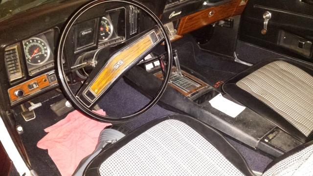

The interior photo shows special instrumentation but no clock indicating the gauges were added or the dash cluster was replaced. There appears to be some aftermarket button added to the left side of the dash. Console is broken in front of the rear ash tray cover.

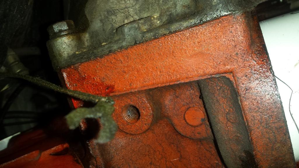

The partial VIN was stamped into the vertical flange on the side of the block by the oil filter. It's as cast, not machined smooth. The stamping can be very faint and difficult to read.

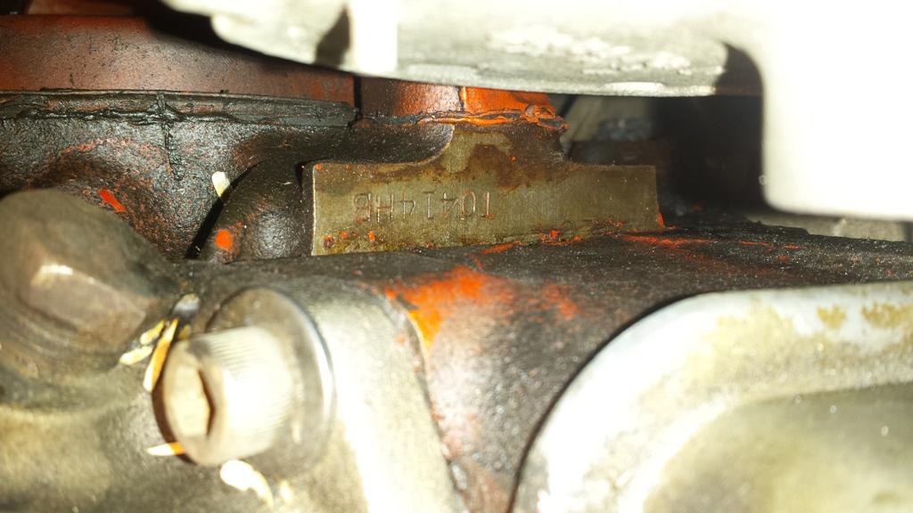

The engine code will be on the machined pad under the alternator; much easier to read. Code for a 350/Turbo is HB; HE for a 350/Powerglide.

Post up the engine code. That tells a lot.
Originally that was a 729 white houndstooth interior. Changed to black houndstooth.

Ok I got a good photo of the Tonawanda stamp. T0414HB. The partial vin I can make out 3 of the numbers. The actual vin is 124379n631752. I can make out some but not all of the numbers. I do believe it is numbers matching. I will try to get it to show up better sometime today. Next to the Tonawanda stamp is 020 that half is under the head. I'm assuming that someone stamped that later indicating .020 over size bore.

Looks like a matching numbers motor, which will certainly help resale value.
If you can see three characters of the partial, that is better than most with the engine installed.
