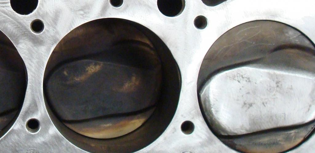

How can you tell the difference in a real four bolt block (1969 512 )from a two changed to a four?the oil cooler and oil pressure holes are bigger in a four ,but are easy to change. Any other ways to know for sure its a real four bolt???thanks John any pictures would be very helpful

They always do not put in the valve relief in the cylinder

"They always do not put in the valve relief in the cylinder".......John, you are right on the valve reliefs . He also left out 3-4 more signs,with one being the tell all , especially for such a long video . Seemed to focus too much on the line hone,which is really ireelvant in that most blocks get that regardless if they are converted or not.
