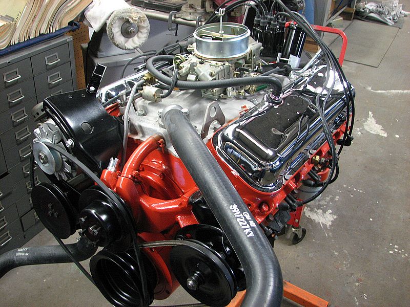

We just did an LS6 engine restoration for a customer with a windowed block. He shipped the block to Europe (not as expensive as you would think) then to an engine builder in California and finally onto me. Don't quote me but I thought he said between the boat ride and cost to fix it, it was around $2000. The engine builder ran the engine hard on the dyno with no issues and best of all, I could not even tell where the block had been damaged when I got it back. There are many people that can fix these state side so no need to send it overseas but that is where the customer chose to send it. The point to all of this is, if you can save it do so as total cost to repair, rebuild and restore this engine was less than a new crate motor would cost and he still has his original numbers matching car.

Yup, that's mine. Threw a rod back in 1981 that took out the lower cylinder skirt on the back two cylinders. Unfortunately, not enough left at the bottom of the cylinder to install repair sleeves. Engine sat until 2010, when I sent the bare block to a very respectable company called <span style="font-weight: bold">Cast Iron Welding Works</span> in England. They built up the bottom of the cylinders with the same cast iron material as the block by fusion welding. It actually cost more in shipping than the actual repair cost. Once back in the USA, Mike Lewis at <span style="font-weight: bold">Lewis Racing Engines</span> in California sleeved the back two cylinders and did all the necessary machining work, complete rebuild and dyno break in. There were no guarantees with the whole process, but I feel I made the right choices on who performed the work, including Rick Nelson for the final restoration. And the important numbers are still in place. Well, the engine project would have eventually come to light, and it looks like this is the best time for that to happen. The final picture says it all. As I have said all along, &quot;It is what it is&quot; Thanks Rick.
Henry D.
