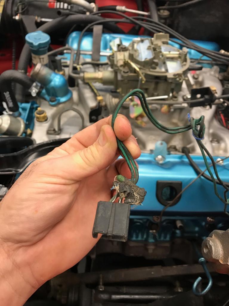

where does this connector go?..double green wire with a resistor?..long lead too. 70 W 30 auto ac car.

Check the A/C compressor ... TAZ

ac compressor is on pass side..this is on drivers rear of motor compartment

If an A/C car -- was there ever a throttle kicker on the carb?

Tcs vacume switch on a bracket passenger
Side of intake manifold ( switch probibly gone)
The vacume part of the switch is plastic
And drys out due to age and engine heat.
Mounted on a bracket that bolts to an intake
Manifold bolt .metal bracket painted engine color.

thanks dave!
