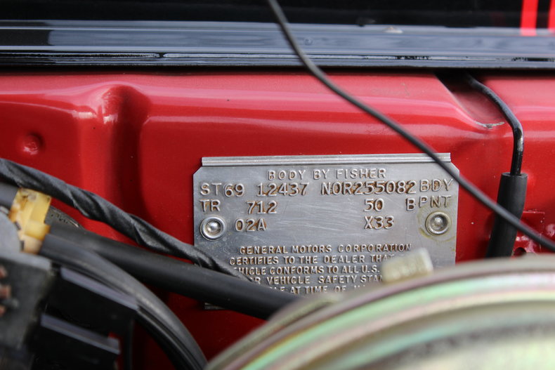

Says this car was just certified as a real z28? Ebay # 112299518910 That cowl tags looks pretty fresh to me..What do u guys think?

Hmmmmm, let's see....a dealer selling an alleged MacNeish certified, recently restored 69Z for $39K? Something doesn't seem kosher to me. I agree, the TT looks WAY too nice to be original.

100% certain that is a fake tag. Not just from the aftermarket rivets that were incorrectly installed.
body number is NOR255082
VIN 124379N592877

Wow that's a very old fake trim tag. They're getting much better now.

Was ended early because of an &quot;error&quot; in the listing.

In the Ebay ad it states it's a &quot;Tribute&quot;
