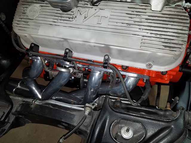

Not uncommon. Mine ended up needing several shims on the driver's side when I had it aligned two years ago. Not a monkey doing it either...
This is what it ended up with.
-Dave
