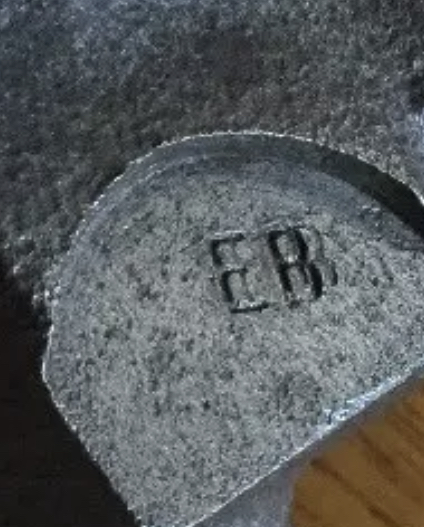

Opinions on this 5470409 master cylinders EB stamp? Any concerns? Looks like stamped striked multiple times or over top another?

it looks like a good stamp to me. I compared it to my 70 z28 and 70 L78 camaros. It looks just like them other than the 2nd overstamp.
What about this one? It's on my 70Z. It has the same stamp bounce thing going on. I believe it's an original finish master cylinder.

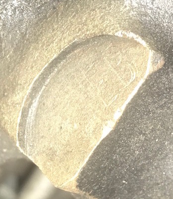

Here's another original 70 EB stamp I owned at one time with what appears to me being the same font as the original one on my current 70 Z28.
