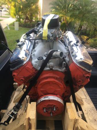

This running L78 motor looks like a good deal at $3,500. Original VIN was likely 138378B232659
https://orlando.craigslist.org/pts/d...844292398.html
Block # 3935440 – 4 bolt main.
Block Cast Date – F 12 8 = June 12th 1968
Deck Stamp T0715 EG = July 15th 1968
Partial Vin # 18B232659
Pistons are .060 L2287
Heads are 3919840 dated F 8 7 and 3964291 dated D 13 70
Rockers are Crower 1.70 Roller Tip
Edelbrock TM2R Intake
Holley Street Avenger Carb # 80670
Great Running Motor was just pulled out of a car to Put 427 in.

If the motor runs well it is a bargain, it would cost twice that gather the correct parts and build it.

That is a rare cast date on that 291 head (April 70)
Wonder if 1.88 exhaust valves were put in the 840 head?
And I bet that it is a 1980 CFD 291 head?
