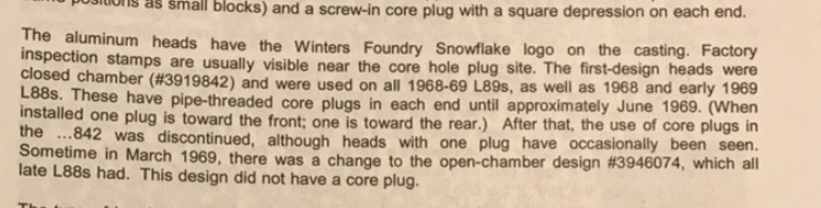

I don't think the 074 opened chambered aluminum heads were ever used on 1969 L89 corvettes. I believe only later L88 and ZL1s. I believe all 1969 L89 corvettes (even late ones) got the 842 casting closed chambered aluminum heads. That paperwork, in my opinion, is questionable and the stamp pad needs cleaned and closer examination. I would suggest if anyone is serious about the car (pay the fee) and have the shipper/tank sticker numbers sent to the NCRS to validate it. Not going to validate any of the cars options but it will tell you if that is the correct tank/shipper order numbers for the car. In my opinion, the car has way too much going for it, if you know what I mean. The car is way over priced even if everything checked out
The ad isn’t totally wrong. The 842 is a well known application on the early L89s. It did not have a plug on the face of it. Easy to tell the difference (amongst others). The 074 was used in non early production.
I would argue that 074 were used on 69 L89s. I believe that 842 were the only aluminum head used on L89 corvettes in 1969 and the newest 69 NCRS judging guide does as well.
