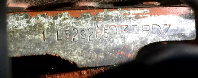

L78 Pace Car - unrestored survivor, original paint, all original factory sheet metal, born with drive-train including L78 396 375hp engine, CX Turbo 400 transmission and BT coded 12 bolt 3:55 posi rear end. The engine is standard bore and has been completely rebuilt as has the transmission, brakes and cooling system. All have less than 300 miles since being rebuilt. The interior is mostly original except for the carpet. The driver's seat cover is not original but is a factory seat cover as is the boot. Both were purchased from a member of this site. All door and quarter glass is original. The paint is 95% original with some minor repaint on the spoiler. Paint is not show quality after 50 years. Has complete factory correct smog system and correct Gardner exhaust system. Minor rust at the tips of the fenders and quarter panels. The remainder of the sheet metal including the floors and trunk pan are 100% solid and rust free and still show factory over spray. Many original grease markings still exist on the car. Odometer reads 92,XXX miles. Documented with the original signed dealer sales order obtained directly from the original owner along with signed correspondence.
Regarding the casting date on the block. I have no idea why the casting date on the block precedes the build date of the car by 9 months or why the block was decked. What I do know is there are factory stamped vins by the oil filter and on the top of the transmission, all hidden vins are in-place and available for inspection and I have the original dealer sales order that I received directly from the original owner and complete owner history.

Could you post a picture of the block date?
Something is not adding up
If it was a H 14 8 it would be a 440 casting
If it was a H14 9 it should be a 854 casting
the vin is clearly in the range of the 272 casting that is why I'm asking
should be a April stamped block...…..
Nice car but something doesn't add up
If someone else can shed more light - please let me know

Hi Fred
Posted a picture of the block casting date. Looks clearly to be an H 14 8 and a 272. Seams early for a 272 but there it is.
Rick
Old 04-29-2019, 12:13 AM
the427king's Avatar
Join Date: Jun 2011
Location: CT
Posts: 7,070
Thanks: 217
Fred in print the earliest 272 blocks are said to be sept 68. Ive had H of 68 272s before...if that was a 854 9 date it would be stamped on the top as you know.....
