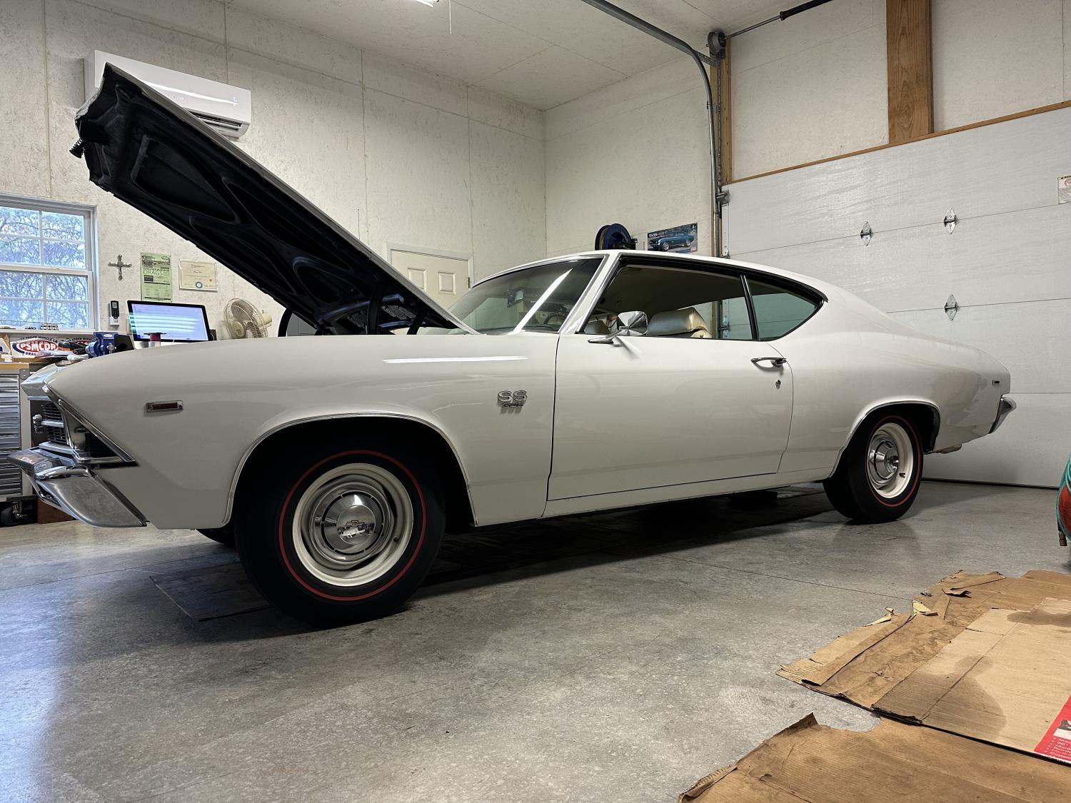

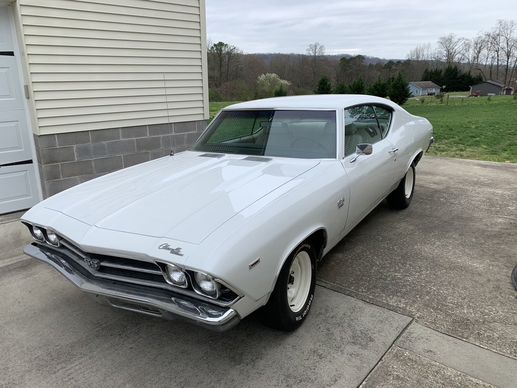

Well I bought a white on white 1969 SS396 Chevelle. I did not go see the car, just looked at pictures, so the car is not all I hoped/thought it was. I have been looking and checking the car over, and if anyone has any info, or knows the car, I would like to find out all I can. Car has papers and is a factory L-78 car, sold through Scuncio Chevrolet.
I know the car went through Barrett-Jackson last Oct. with the black stripes down the sides, but car does not have the stripes now. Checking showed new quarters and a new trunk floor. Also looks like front end may have been off for work. New paint job explains where the stripes went.
Salesman told me the engine was not original and was just a big block of some sort. Well, he couldn’t have been more wrong. Engine is a date code correct L-78 from a Camaro that was also built with a Turbo-400. Engine and rear end were built 1 day apart.
Turbo-400 is from a 1970 oval port hydraulic cam engine, but it shifts good.
But everything is sort of a mess.
There is rust, with some pin holes, probably get bigger when the work starts, around where the trunk seal goes. Lower portion mainly.
Interior shows signs of mold, like the car set for a period. Needs replaced.
Under the hood needs plenty. Spark plugs were wrong for the engine, plug wires a mess, PCV hose routed wrong, needs new wiring harnesses, radiator cap wrong, battery box rusted, etc. Wrong carb, inner fender liners cut for headers.......
Lots to do.....but if anyone knows much about the car I would like to hear from you. Thanks

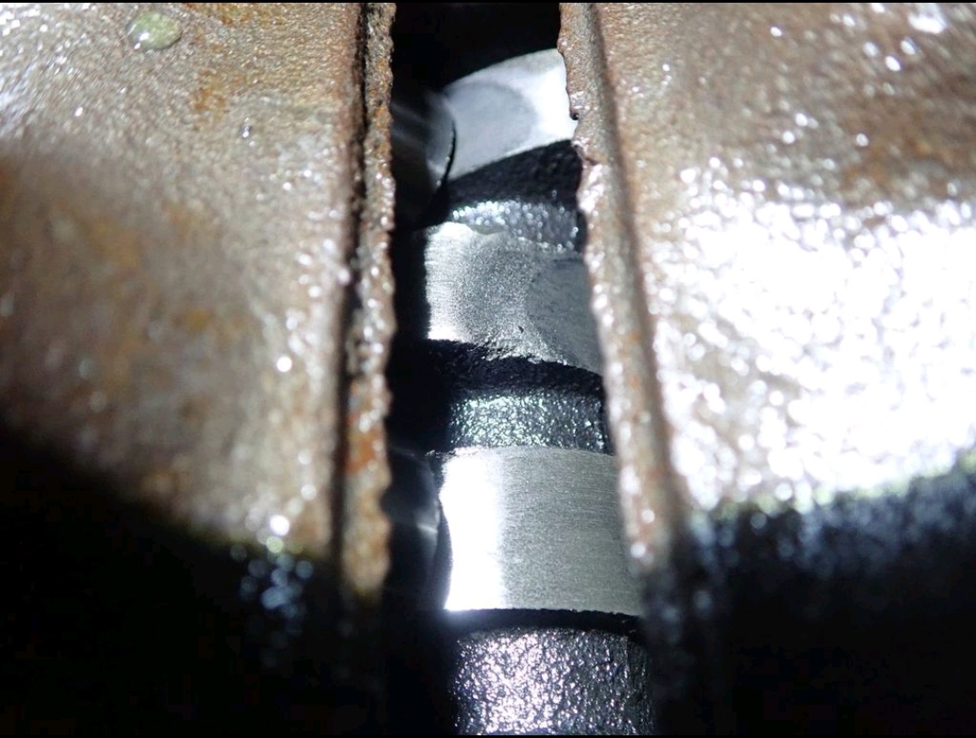

Well I have 4 wheel brakes now...lol. Only the rear drum brakes were working when I got the car. I replaced some of the drum brake hardware parts so that the springs that hold the brake shoes in place sit straight and work properly. Car came with new brake drums on it. Replaced all 3 brake hoses as the 2 front hoses showed some fraying and all looked original. Front calipers were ‘frozen’...so had to replace them. I had a hard time bleeding the calipers, vacuum did not work to pull fluid through system for bleeding. I had to have someone push the brake pedal to ever get the system bleed.
Also the car would drain the battery if it sit overnight. I determined that the alternator, which was not the right one for the car, was the cause and have replaced it.
After all that I did take the car for a short 3 mile ride. Much more work to do. Car seems to sit way to high. I know it has 15” tires and wheels but it still feels like it is much higher than normal when driving. Rear fender welds are much higher than the tires. May need to replace coil springs. What is left of ‘Hurst’ stickers/decals on the shocks.

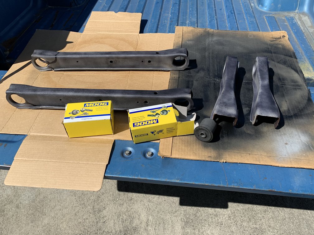

Question.....was putting stiffer/taller rear springs in these cars something racers did....to maybe clear larger, wider, slicks?
Thanks
Old 09-29-2019, 10:08 PM
Join Date: Aug 2003
Location: Chicago Suburbs
Posts: 12,342
Thanks
Tom,
Yes, they did.
