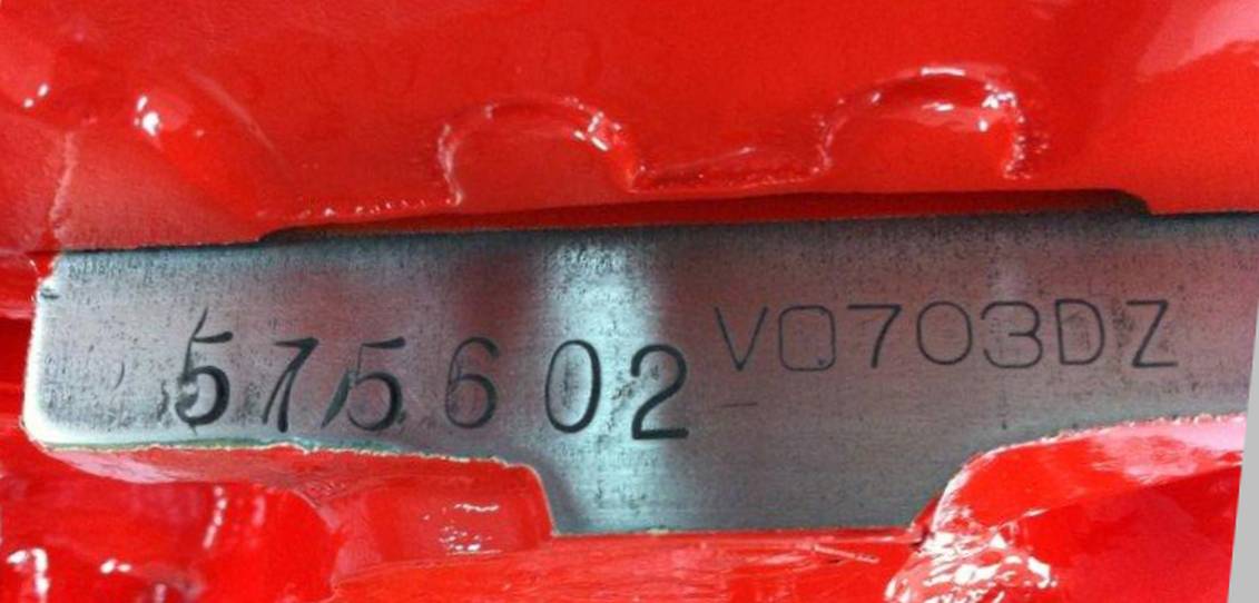

Is anyone on this site familiar with the CanAm 302 cars that were made by Vauxhall, in South America? I have an inquiry from a friend that has been asked to build a 302 for one of these cars and we don't have a lot of information the engines other than the fact that they were 302 Chevrolets and that they appear to have been produced in the spring of 1972. Also looking for any information on the brake proportioning valves that were used on the cars.

We are also wondering about pad stamping. Some of the guys from SA say that it was DZ, Like 69 Camaro's. It looks like from the picture that they used 472 intakes with the freeze plug where the oil filler tube went on 67 and 68 Z28's. Many questions.

Deck Stamping
I received pictures of two CanAm 302 deck stampings, along with VIN's which happen to be 50 numbers apart. Wonder if it is the two cars in the article about the Vos brothers? I forwarded them to Kurt S as I am not proficient at posting pictures here yet, so we should have available here soon. The are both stamped DZ and from the Flint plant. Thnaks for the great story.

Also very interested to see the block casting number and cast date, as well as the assembly date - surprised if Flint was stamping DZ suffixes in the 72-73 timeframe, but would also be surprised if they had 100 stamped at the time of original 1969 MY production left over.....
