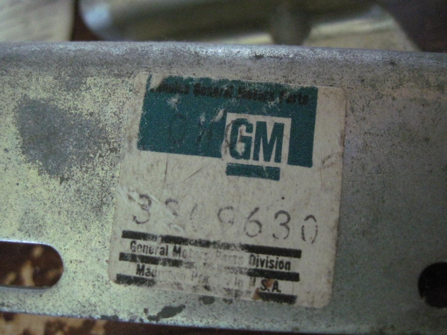

I somehow figured it out I will send you pic tomarrow when I am with the Engine.
Old 06-08-2020, 04:46 PM
dmarr35 dmarr35 is offline
Join Date: Dec 2018
Posts: 62
Thanks: 14
Thanked 32 Times in 10 Posts

Thanks! That shows the extra hole is sheared off. And I’m confident the vacuum pipe will fit there as well.
