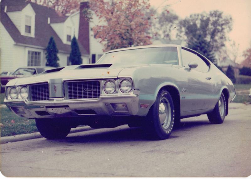

Old 10-31-2020, 12:51 AM
firstgenaddict's Avatar
Posts: 5,596
Thanks: 161
Wthirty1 -
I saw your car list... and with 29 posts I figured there had to be a picture of the rarest color combo, which I have never seen on an olds...
W31 Platinum with Blue Buckets and Blue stripes...
We can't let you out of here without a couple of pictures of that BEAUTY!!!
I love silver over blue or Black over Blue!
~JAG~

Old 11-02-2020, 04:57 PM
wthirty1 wthirty1 is offline
Join Date: Jul 2015
Location: Chicago, IL
Posts: 74
Thanked 51 Times in 17 Posts
Originally Posted by firstgenaddict View Post
Wthirty1 -
These are vintage pictures from the '70's but they're the best to really show the true shade of the blue. I haven't seen another platinum / blue stripe W-car but I'm sure there's another one out there.

Old 11-03-2020, 01:43 AM
Join Date: Aug 2003
Location: Chicago Suburbs
Posts: 12,342
She sits perfect....as in stance
