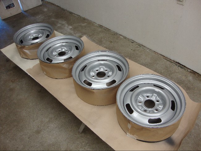

Has anyone in here painted an NOS black grille the correct silver?
I have done silver to black for an SS Chevelle and used SEM Landau Black.
But this time I need to go Black to silver for my z/28.
Was hoping to find a spray bomb paint that replicates this the best.
Any got a remedy??
Thanks

I did mine a number of years back using Eastwood Argent Silver. I would say it turned out good.

I did the same thing with my 69 Z-28 grille. Turned out well also.

AU Omni is single stage urethane and is quite durable too. May be easier for your painter, if he isn't familiar with enamel.
I've used the Eastwood Argent Silver on wheels and it is a decent paint, but the Omni would, in all likelihood, be a better and longer lasting product.
