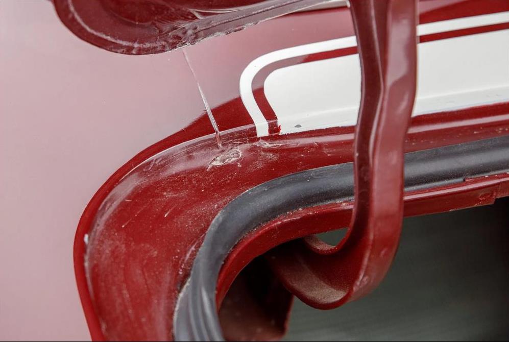

Old 01-27-2021, 12:55 AM
firstgenaddict's Avatar
Posts: 5,596
Thanks: 161
Originally Posted by RSSSfan View Post
I like the burgundy - relatively rare color. too bad someone went and spray-bombed the engine compartment. Should have white overspray across the top of the firewall.
The car originally had RED stripes you can see where the tape pulled in the trunk jamb and exposed the RED.

Old 01-29-2021, 02:20 PM
Lynn Lynn is online now
Location: Oklahoma
Posts: 7,757
Thanks: 89
Thanked 3,564 Times in 1,504 Posts
You referring to this pic James? I think you may be correct. Where else would that red paint come from? Are there other ones documented this late in the model year? I thought the red stripes on Burgundy cars only happened early in the model year, then got changed to white. If originally red, shame they didn't go back original. Of course, the owner probably got tired of every Camaro expert telling him the stripes were wrong.
Location: Oklahoma
Posts: 7,757
Thanks: 89
Oops, I mean THIS pic.
