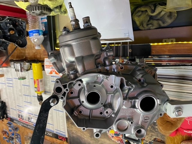

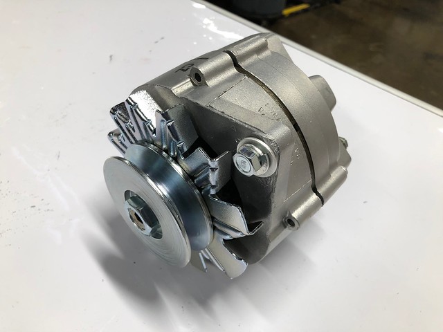

Has anyone used vapor blasting to clean aluminum parts like intake manifolds and valve covers.

I had a friend vapor blast my aluminum valve covers. I had already bead blasted them with glass bead. The vapor blast darkened them just a bit and created a better fingerprint-resistant finish.

It works well on aluminum but not normally to clean it as vapor blasting is a finishing process. Mostly we first solvent tank the part to remove grease, then dry media blast before vapor blasting for the best results.

Hi Chick, if you have a look at Post #343 on my build thread there's an example of an intake I vapour blasted for a buddy with a 69 Z. It appears shinier in the photo than in person due to the lighting. I also did a set of valve covers for a friend who has a '70 Z and compared them with a set I sent out for reskinning - can't tell them apart. We also have a tumbler in the shop and a variety of ceramic media that works well on parts like intakes that don't have fine crevasses that the tumbler media can't reach.

As previously mentioned, I used it on my dad's intake manifold and thermostat housing. Inexpensive and amazing. The vapor honing actually seals the aluminum on a molecular level making it more impervious to stains. Highly recommended!
