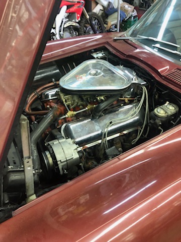

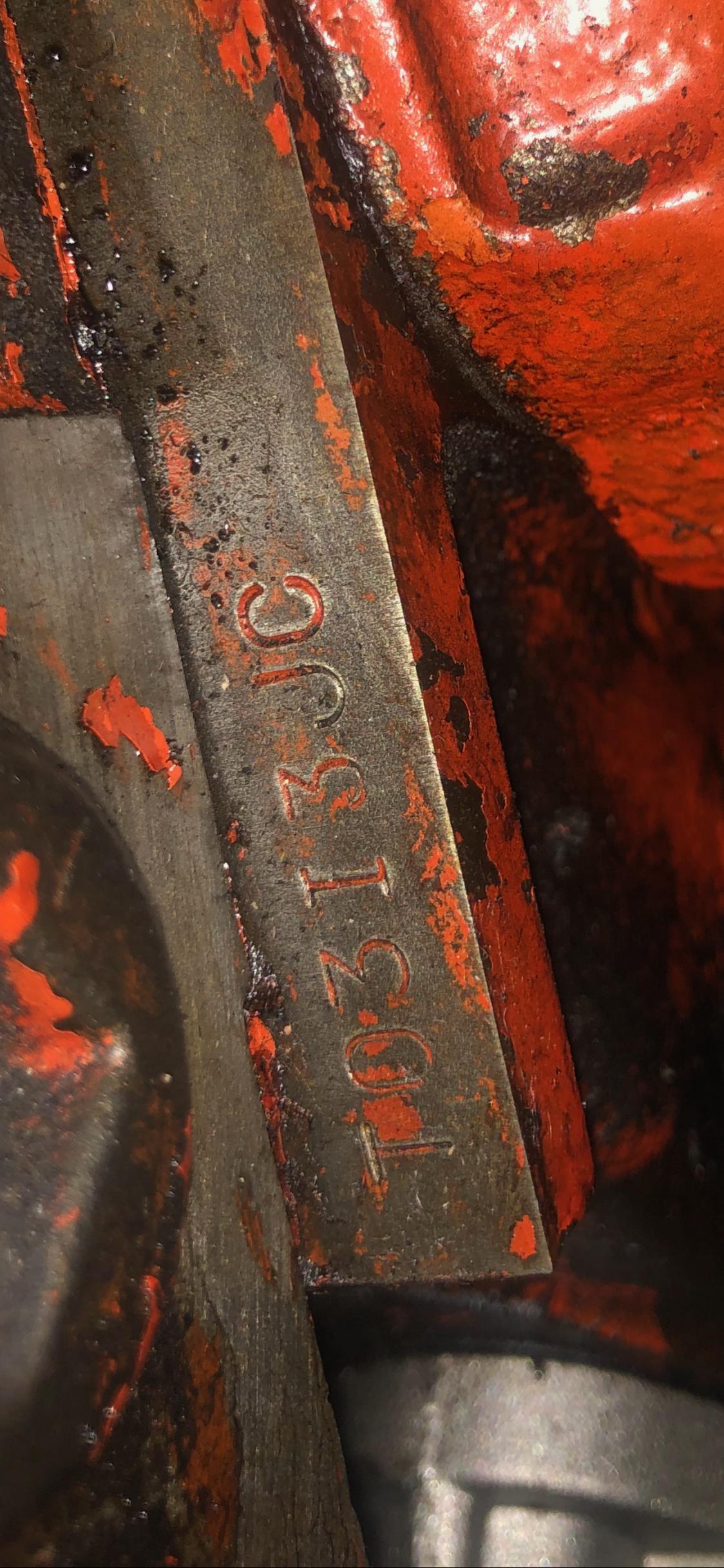

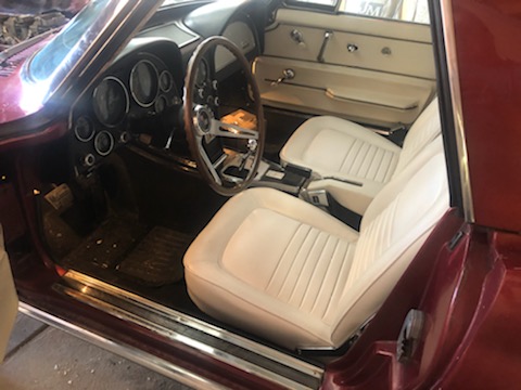

2 top car matching number motor car had been sitting since the 80s . Has pop tank sticker that shows red stripe tires. Also shows engine cylinder conditioning I’ve been told means the engine was blue printed from the factory and maybe came with chrome valve covers somebody rattle canned the intake orange over the years but the engine paint is original the Vin and engine code stamp it is very clear which matches the protective plate the paint looks better in pictures than it does in person. Somebody’s change the exhaust in the shocks but other than that the car is very original I’m not Corvette expert I’m more of a Camaro Guy ! Odometer shows 46k

In 20 years with these cars, I have never seen a tank sheet with that callout for cylinder conditioning. I would love to know more.
I absolutely believe the tank sheet and stamp are real.
VERY interesting car, not your run-of-the mill 390/400. Original engine, tank sheet, POP, and killer patina
