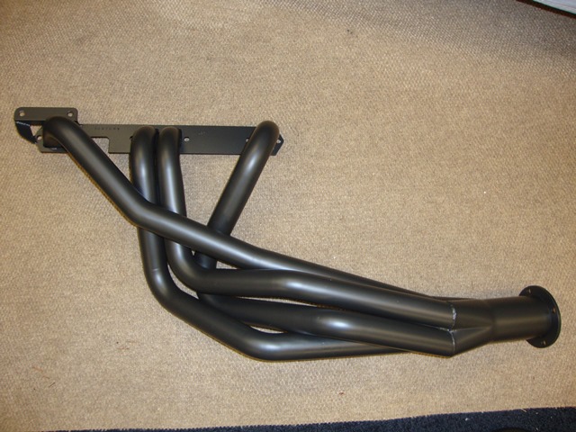

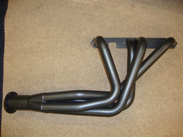

What is best header to use that is closest in appearance to stock originals? And are they reproed?

I would call the guys that bought all the tooling from Jerry Stahl they are in PA and are making headers now.Jerry had originals that he was duplicating.

so the guys that bought out Jerry Stahl when he passed are ACP headers check there web site phone 717-846-1632

When Jere Stahl built headers in the late '60s he used the same upper flanges that were used on the '67 Camaro factory headers made by Bill Thomas/Douglass Muffler Mfg. The upper flanges changed in the '70s. The Stahl headers (now ACP) are premier headers but they do not resemble the factory headers used on Camaros back in the late '60s. Larry Christensen was reproducing the factory OEM style headers as recently as a couple of years ago but I'm not sure if he still is.

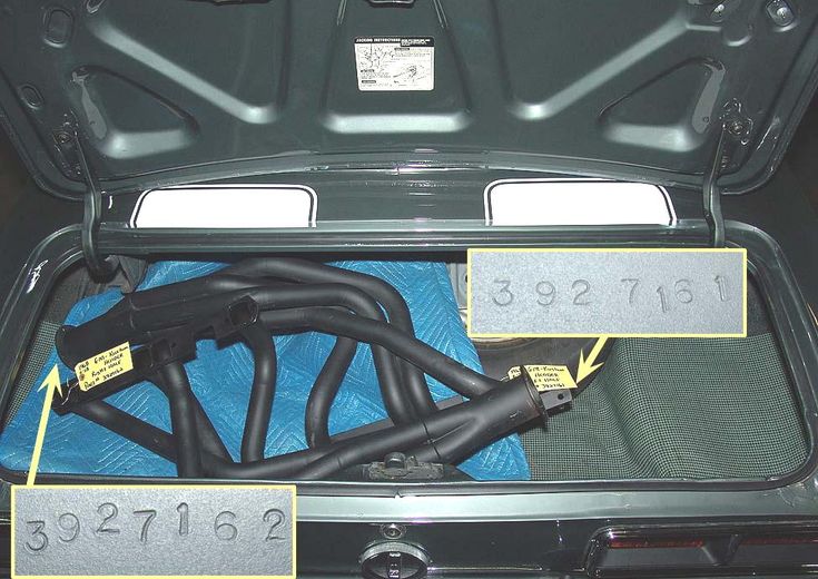

I got these headers with a bunch of NOS 69 Camaro sheet metal they were painted the same as the sheet metal would anyone know anything about these
