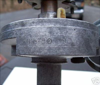

i have an early dated 1111480 distributor, looking to see if anyone else has seen this date.
I am looking to sell it but not sure what it is worth Last edited by LITTLE TOMMIE; 09-12-2023 at 10:45 PM. |
i got this distributor with a car and it is suppose to be an original but would like your input
Need a clearer pic to be certain.
111148 all look good. The zero is suspect. Is it just damaged or are there remnants of a previous digit? Lots of other get "converted" to 480s. 483, 488, and 489 are more common.

Also, these were normally run I batches, I believe. May see if you can find a legit with the same date.
Pic of a legit one from Jan, 69.

might be the pic but the o is not right,too oval.
Ebay Auctions http://www.ebay.com/sch/427-king/m.h...=16&_rdc=1 No Fisher priced toys here |
Agree - 0 does not look right. Looks like another number was underneath and redone
My 1111480 dated 8 G 19 for a 10B Oct 68 Z.

8g8 is not a good date.
ok thank you guys for all your help
