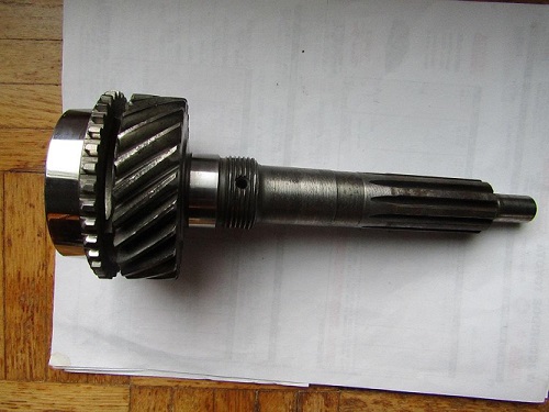

Ralph,1 ring on the input shift is close 2.20 ratio. 2 rings is wide 2.56 ratio. No rings is m22 on the Muncie factory input shafts.

I have a 64 input shaft with 24 teeth with no rings (wide ratio) , the tag that was removed from same tranny that reads 3841435 if i remember correctly was a 3.36 rear ratio. Maybe some one can confirm .
Early Muncies don't follow the same rules as later ones do. I also had a wide ratio 2.56 (325 case) with no grooves on the input.
Thanks, do you know when they started using the rings?

Looks like 63 through 65 had no groove on the m20 and 1 groove on the m21. I did not know that.
