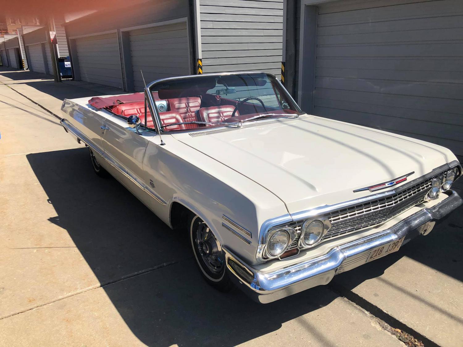

For the big car fans, my friend is the 2nd owner of this 409/powerglide car, his aunt was the original owner.
The Following 4 Users Say Thank You to Pro Stock John For This Useful Post:
69M22Z (01-20-2022), dykstra (01-20-2022), L_e_e (01-20-2022), RPOLS3 (01-20-2022)
