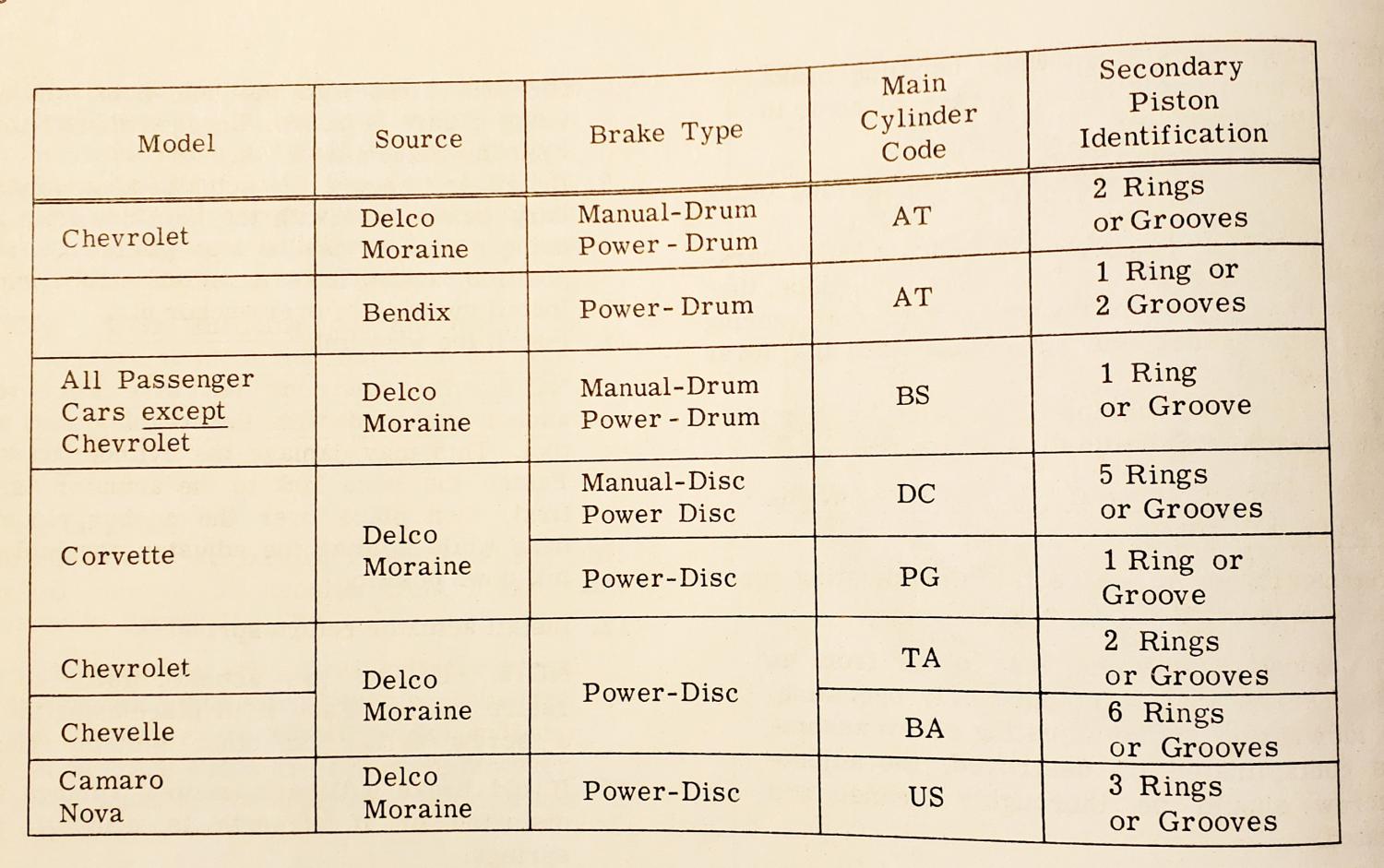

Old 02-24-2022, 05:00 PM
Kurt S Kurt S is offline
Location: Ann Arbor, MI
Posts: 3,079
Thanked 772 Times in 361 Posts
The 69 Nova disc mc is stamped US.

Old 02-24-2022, 11:31 PM
BigD69 BigD69 is offline
Join Date: Feb 2017
Location: Ohio
Posts: 236
Thanks: 26
Thanked 24 Times in 12 Posts
Default Master Codes
Here is a pic from the 1969 Chassis Service Manual.
