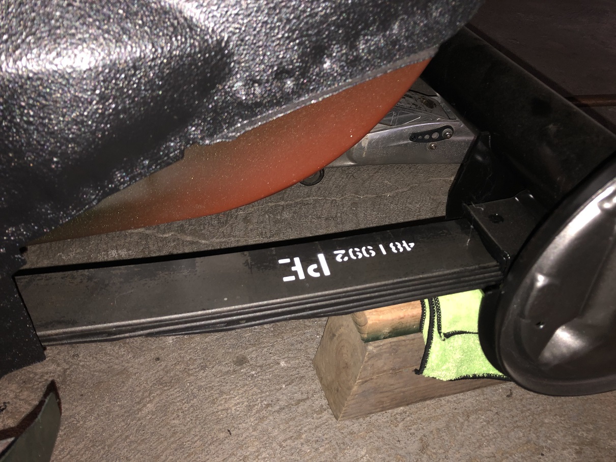

As requested...this is the best photo I have in my library for the car...if you want to see any different detail, let me know.

Steve, if my 70 comes out half as good as yours, I will be happy. Awesome detail work!

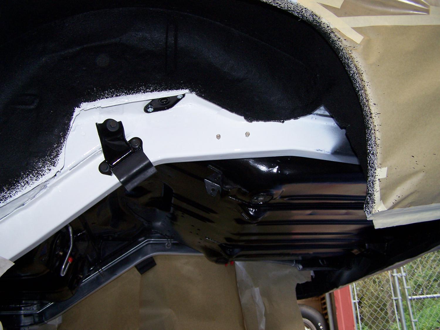

Default 3M product and applicator gun RESULTS
This was my amateur attempt on my Driver Z11 (LOS)
Using the above 3M product and "gun"
Frame on underbody Fluff.
