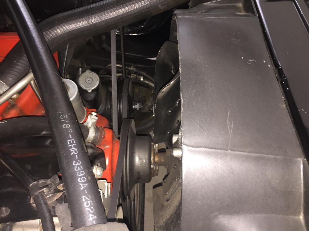

Helping my neighbor with his 69 Chevelle re-fresh...have a few questions:
Malibu cloned to SS396...325hp w/ 4spd and power steering.
-the fan shroud doesn't look deep enough...fan blades are barely inside...the shroud measures 2.5 inches in depth...seems to me it should cover the blades more completely. He has a long water pump...with clutch fan setup.
-there is a brown wire with a 90* end [looks original] that is near the brake booster. Is there supposed to be an idiot light connection for the brakes?? He installed a repro booster, master cylinder combo...
-proper way to bleed brakes for this car...should he remove master and bleed separately?? or can we do this installed?? of course, we don't want fluid on the fresh paint...please advise.
-what is the correct routing of washer hose to squirters [mounted under hood]..I see 2 round holes in the plastic mesh near the windshield..??
-correct place to attach negative cable...I think it goes on the block...??
-he made new inner fender flaps...needs the staples to attach...best source??
well that's enough for now...many thanks in advance

Below are some of my thoughts on your questions, hope this helps,
-the fan shroud -Check the shroud to make sure it is correct, also you can check to see if it is pulling air through the radiator
-there is a brown wire with a 90* end -should be the brake light wire for the proportioning valve on the frame below the bell crank area on the drivers side.
-proper way to bleed brakes for this car...Master cylinder should alwasy be bench bled off the vehicle so it is level and can get the air out. lay fender covers and use rags to help mitigate the fluid getting on the fenders and inner fenders. bleed as you would normally after it is installed.
-what is the correct routing of washer hose to squirters when you say plastic mesh i assume you are identifying the screen many put on them that is incorrect if you are restoring it. The firewall has two holes near the wiper motor for the hoses to pass into the cowl area and them the hoses are run to either side and connected to the squirters on the hood. there is a clip that goes on the drivers side to help hold the hose since it is longer and needs to avoid the wiper transmission movement. through the holes on the screen might require a little more hose to reach the squirters and look decent but watch for pinching of the hose when the hood is closed.
-correct place to attach negative cable...I think it goes on the block..yes to the boss on the pass side it may even be part of the head.
-he made new inner fender flaps...needs the staples to attach...best source?? not sure of a source but you might be able to use a stiff solid wire that can be bent to retain it, the old inner fenders might have holes you can use to get an idea of the size.
Andy

Can someone please give me the depth of the shroud??? pretty sure this one is not correct.

Fan should be half in and and half out.

We took the shroud and fan back off...
These are the numbers from the fan...
497840. 916088 E77
the shroud has these numbers 3938165...it is not correct based on what has been posted and what I have seen online...
https://www.npdlink.com/product/shro...ro/110263/7201
If we get the correct shroud will this fan be ok..??? or do we need to buy a fan, too. If anyone has a correct factory shroud and perhaps the fan we may be interested.

The shroud is the 69 assembly line item, which is pretty rare to find. Fan blade should be the 772.

3938165 is the correct number for a 69 BB fan shroud. The later number is a replacement.
Most MCs I've seen from 69s are painted black. Bare cast has been seen too. Personally I'd paint it either with black or a cast paint. It will rust.
