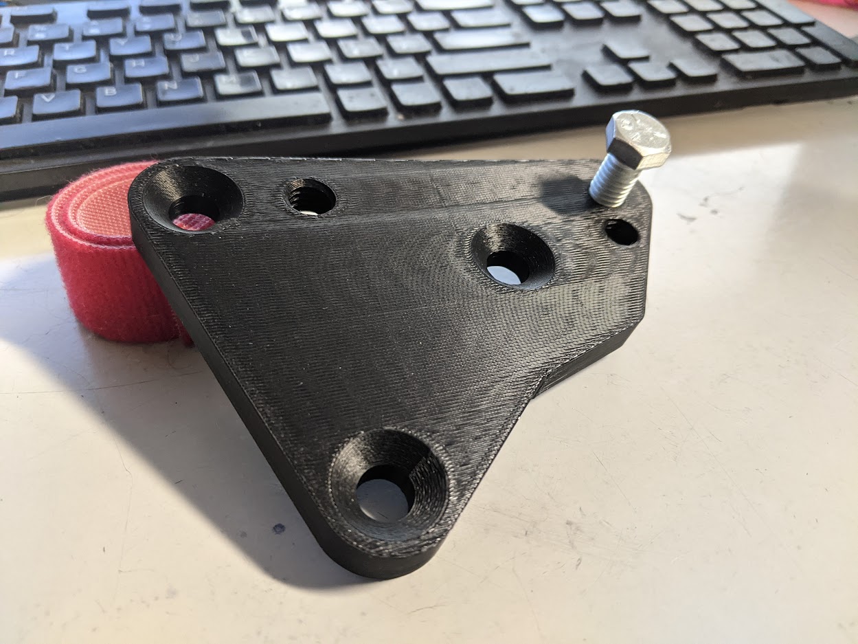

Be advised- if you want to bolt that shifter to a ST-10, you'll have a bit of trouble with the adaptor plate. The 69 used a different bolt pattern on the trans tail shaft housing- so you can't just use the stock Muncie shifter plate.
I just modeled and 3D-Printed this Plate yesterday- it is exactly what you need to use the stock 69 Shifter with a 70-up Muncie or ST-10.
I just put a 1970 M22 in my 69 Z28, and used the original shifter.
The 70+ shift levers are different too- but they swap right onto the linkage rods no problem.

I had to make a mounting plate similar to that when I installed a ST10 in a '69 Camaro.

I put a ST-10 in my 65 GTO- but I was able to use a 71-81 Camaro Adaptor Plate.
Worked perfect- even with the factory console.
That plate won't work with the 69 Camaro factory console though
