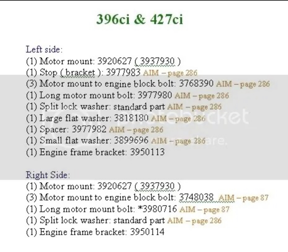

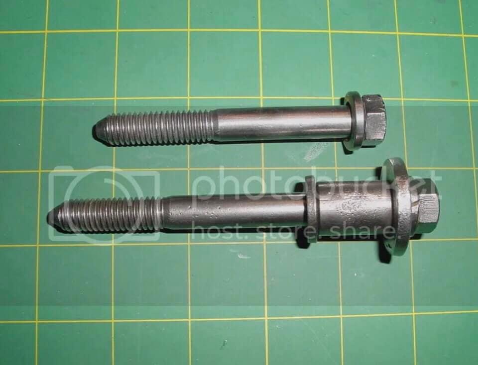

My research at this point has identified three suppliers were used for the motor mount bolts used with 3920627; 3937930 engine mounts on 69 BBC 396, 427 COPO Chevelles, Camaros that were assembly line correct or offered over the counter through the GM Hi-Performance catalogue.
The two bolts were different in length to accommodate the safety mounting plate and were 7/16”-14.
The manufacturers’ insignia on the head of the bolts were:
RBW
L5
RSC
Does anyone have any additional pictures of this hardware and insight that can be shared?
