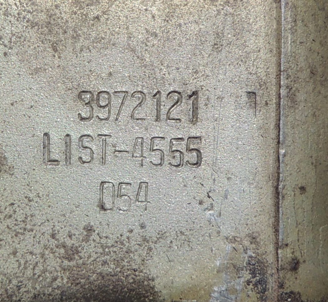

This car deserves to be done right. Born with engine (not in the car right now... that's another story) trans and rear end. Pretty certain the radiator is original, but I didn't see a tag. The only deviation from stock will be a set of adjustable Koni shocks and the GM part number headers and side pipes I got from Tony. BTW, if anyone is making a trip this next week or two from the Detroit area to Wisconsin, you could really help a brother out running the first leg of the relay to OK.
Manual brakes, and, like all early LT-1 models, no PS. My understanding is that a few were made with PS late in the model year, but the compromise is that they had to use a smaller oil pan.
