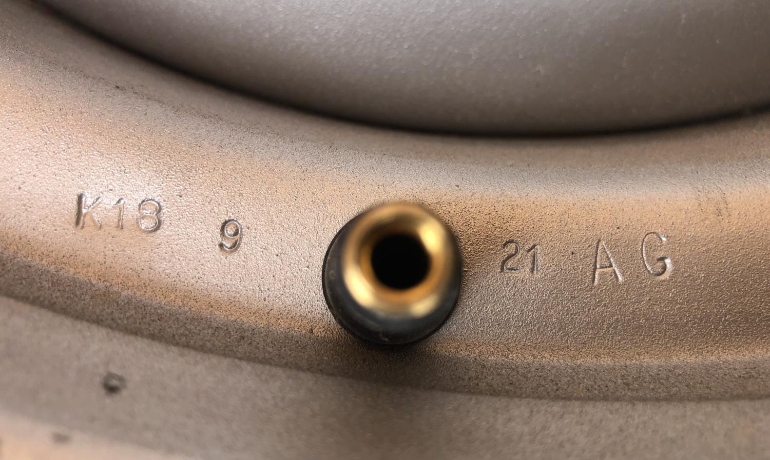

My 69 Camaro project had 2 68 Corvette AG rally wheels on the back. Both dated 9/21/68. They are in pretty good shape. Any suggestions on what they might be worth? Thxs

I just purchased a set (4) of beautiful 1-31-68 AG rims with no curb rash and acid dipped for my 68’ L89 Corvette.
All ready for paint.
I paid $125 a rim which I thought was a good deal.
I paid $175 a rim for a set (4) of date coded AZ rims for my 1969 L89 Corvette.

The 9/21/68 AG wheel date ??? The 1969 cars were being built starting in August 1968

Ralph, Good point. Did they put these wheels on some early 69 cars to use up the leftover parts? Or could they be over the counter replacements? Thxs

AG were 7 inch for 1968 only AZ were 8 inch 1969 and up maybe that was an over the counter replacement but not correct date for any 1968 Corvette

I’d ask $250 for the pair and listen to any offers of $200 or more. As stated, not production date code correct for a ‘68 restoration, but in my mind they’re still 1968 produced and more desirable on a restored car than decades later produced units. I’m sure the stamping and welding details are likely still dead on compared to earlier 1968 produced rims.
