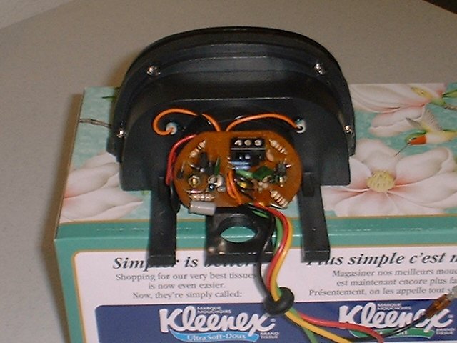

The pic is of an ORIGINAL Yenko Duece hood tach so I know it is real. I have updated my personal info so feel free to read it.
If you have a pic of what you consider a real Yenko tach please let me know.
I know they used Dixco but another was used as I own examples of both and the one in question was NOT made by Dixco but we know came on the car originally.
I have attached a pic of the inside of tach.
Please understand I have seen several like this and that is why I am here asking.

This is a Dixco tach internal mechanism so you may compare to the previous attachment. I have several Dixco hood tachs and one is on my Galaxie so that is how I got started collecting them.

Not so much doubting them but understand the inards of these tachs are different. See the 2 attachments to see they are 2 totally different tachs. The Dixco have black plastic inards and the Yenko tachs are clear.
The question should be I guess; who made the clear plastic hood tachs?????
Dixco did NOT make the clear ones.

First off Dave, you already are off with some facts. BOTH tachs you show are indeed made by Dixco. the 1st tach you have pictured is indeed a Dixco HT/x, but it is definitely NOT an original Yenko faceplate. The Yenko logo is homemade and is not correct, as has already been stated. The "other tach" you post pics of is also made by Dixco, and is a later version of the HT/x. The first one is the correct (for Yenko applications) "1st version", and should feature round bullet-type "push in" connectors on the wires, whereas the second version you show uses regular "flat" wire connectors. The newer version also uses a plastic nut on the bottom to attach it to the hood, where the original version used a steel nut. The second versions I have seen always seem to have the "colored" face, with a red, green, and yellow stripe around the top edge of the face. BOTH versions you show are made by Dixco, and were actually marketed by many different vendors, who often paid to have their own names and logos on the face. Ford, Mopar, JC Penney, JC Whitney, etc. all sold versions of this tach, and all were manufactured by Dixon (Dixco). By the way, What publication are you writing this article for, might I ask? Sounds like Supercarkid already has it written for ya.

My original hood tach has the clear plastic insides that you show.The black plastic insides look like a newer tach.Couldn't they both be Dixico made at different times?Earl
