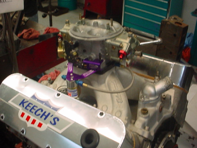

I had some great replies to my last post so here goes again...I have Dyno2000 version 3.1 on my PC and I'd LUV to believe what it's telling me...414hp at 6,000 rpm??
It's a 355 with a 600 cfm Holley, 1.94 camel hump heads, 64cc, headers with 2.5" exhaust and a Comp XE274H cam. I think maybe I screwed up with the cam specs? It has gross valve lift of 480 int and 490 exh.Cam installed at 106 intake centre line, duration at .050 inch...230 int, 236 exh,lobe lift, .3250 int, and .3270 exh. Lobe separation is 110. I know 414 horse is too high, so give me the truth, I can take it....I think

these desktop dynos make me crazy. ok... try changing from your 64 cc double humps with 1.94's to a vorteck 1.94
with 64 cc's. probobly a 30 hp diffrence. but the desktop
cant tell you that. theres too many variables. i had a customer tell me that if he advances his cam 2 degrees he'll pick up 80 hp cuz the desktop dyno told him so. steve

Accurate head flows are the key to using DD dyno. You need to make sure the flows you are using accurately reflect the heads you have. Don't just pick the Wedge/Pocket Porting, Large Valves head flow file if your running 186 stock camel hump heads. You'll end up with some highly optimistic numbers. If you can get the head flows right you'll be within 5 to 10% of the peak numbers. The programs real use is to see the relative differences small changes in cam timing, or changing a cam can have on your engine more than telling you that you have a 411.5HP engine at 6500RPM.

The DD dynos are fun, interesting, and at times can give good ballpark results. As has been said, theres' too many variables that the software can't account for.
In the end, a real time engine or chassis dyno is the way to go. Of course, the 'acid test' is to run it on the 1/4 mile!

Ok, back to the dyno thing...I entered "low performance, large valves" 1.94 int and 1.5 exhaust, did the compression math and it gave me 10.48/1 at .028 deck height and .025 head gasket.13's? Man. I'd LOVE that!!I ran a "street" 1/4 mile once at about 102 mph with an ET of about an hour and 10 minutes ....my 245/60 BFG's don't hook up so good in 1st gear
