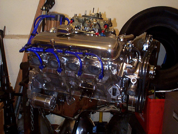

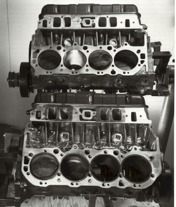

I am looking at buying this block, what can you guys tell from these numbers? Vette or CoPo, or either? Any help is appreciated!!!
-The casting numbers at the rear of the block are "3916321"(it has 4 bolt mains).
-The casting date is hard to make out but looks like "1 27 7".
-The stamped numbers on the front deck looks like "TI0I6TH"
-There is a partial vin on the block that reads " 18J282724"
-The crank is forged, cross-drilled and ".010/.010.
-The rods are 7/16 full floated dimple rods.
Rich
Rich Pern
69 Camaro COPO "Tin Soldier"

3916321 = 427 cid-425hp Passenger or 400hp, 430, 435 Vette (4-bolt)
I 27 7 = Sep. 27, 1967
18J282724 => 1 =(2nd half of body style, can only be 11 2-door sedan)
18J282724 => 8 =1968
18J282724 => J = Janesville, Wi (Passenger model)
18J282724 => Passenger model begins with 100001 so that also holds true.
Now for the ??? Are you sure its TI0I6TH? That's the only one I can't find in Colvin. I found an IH for the 390 hp 427 cid passenger model with manual (1968), but the 390 HP version was only a 2-bolt block.

18J282724 => 1 =(2nd half of body style, can only be 11 2-door sedan) 1 = Division- in this case Chevrolet
One of the last of that block put out also since it was stopped being used in Jan of 68. All the rest checks out.

How could that be a Alum block? I thought the ZL-1 blocks came out in '69?
Sounds more like a alum head L-88 motor but I was not aware that they put them in a Pass car back in 1968 according to the vin #?? That is a '68 S/N is it not?

You guys are right. If those numbers are correct it is indeed a cast iron block.

John Z says its a out of a 68 Caprice from the Janesville plant
