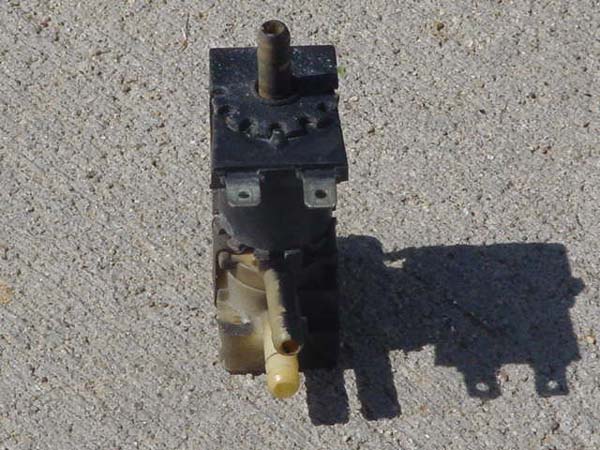

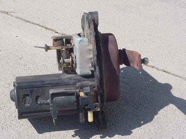

Absolutely baffled! 1969 RS Camaro with hideaway headlights and headlight washer jets. Took out the winshield washer pump and motor to replace and I have found on the right side of the wiper motor as you look at it when it is bolted in ANOTHER SMALL motor with 3 vacuum line and a two male plugs. Could this be a pump for the headlight washer fluid? If so where do I get a replacement motor??? HELP! Thank you! I would be happy to send a pic if someone would like it. Have no idea how to post one on this site.

I am wondering if maybe the washer pump sends the fluid to both the winshield and the headlights at the same time, thru the same pump and someone added this on for one reason or another. I have looked quite extensively and cannot find anything remotely similar to this unit.

Carl..That extra pump is standard on cars with headlight washers. Don't lose it or break it because I don't think anyone repops them.

Charley is correct no one repops them and when you find them on Ebay their an arm and a leg. Most problems with that part is the nipples break off

Does anyone know of a part number that is associated with this???

Group 2.780 3957029 Nozzel, Assembly headlamp washer spray
Group 2.780 3760758 Tee, Headlamp washer spray nozzel
Group 2.780 4919503 Valve, Headlamp washer check
Group 10.150 4919624 Motor, Windshielf wiper/motor only whith Headlamp washer
Group 10.153 4919676 Body, Headlamp washer solenoid valve
Sent you a PDF file as well via Email
