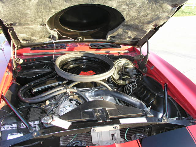

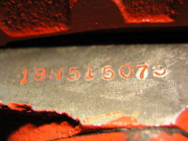

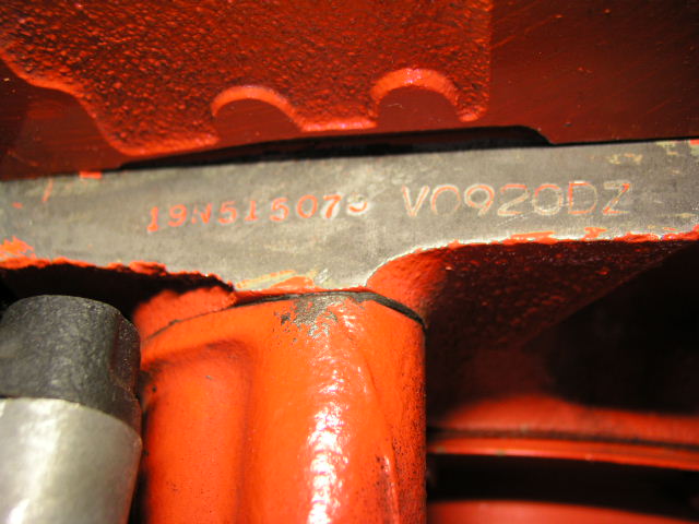

Be very carefull. Post the tag and the stamp pad for verification. Look for single fuel line - holley cars had them. Bracket for dual exhaust - only SS or Z cars had them. Make sure the trim tag is not a "replica" - most important. Check for original DZ stamping - easy to tell if you know what to look for. Later cars have the vin by the oil filter. Too much to learn in 5 minutes - post the pictures. ![]() Also - no 69 Z's had A/C or Auto trans. They all came with smog (Correct E-manifolds cost $1500) |
Here is my early Norwood Z with the vin on the pad.
