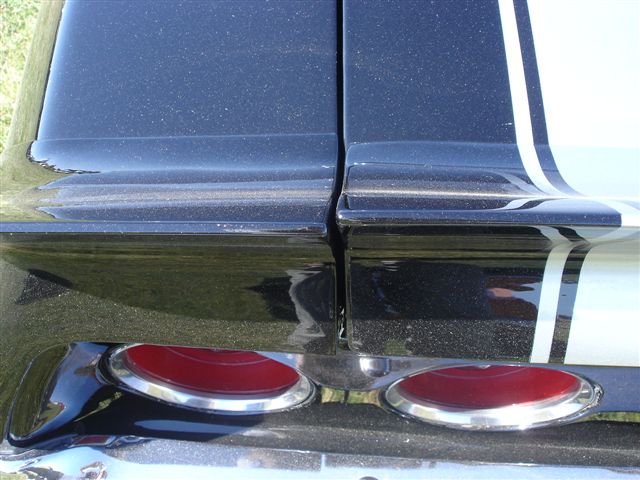

I was browsing old posts and it got me thinking about a car I've had on the back burner for a while, still collecting parts to restore it. Everytime I decide to sell it I end up talking myself out of it. It is a 70 Z28 with the COPO spoiler. I have no POP, window sticker, or build sheet. I have never looked for the build sheet, so where shoud I start? I do have the original title and license plate from 1970. I met with the original owner several years back. His health was failing so I never pushed the issue of original documents. He did verify the 40k on the clock were correct. I have no doubts of the cars pedigree because everything is there from the LT1 to the 12 bolt, all matching numbers. So, without the build sheet or some other documentation, is this car any more "special" than any other Z28?

Norwood 70 Camaros (those with N as part of the VIN) did not come with build sheets. Without a build sheet or window sticker, could not ANY post May, 1970 Norwood Z be converted into a "COPO" Z-28.......I ask you???????

I am glad I sent you the M/I Article, as I cannot get it to post up properly. As for conversions, It can be done and I have little doubt was done to more than a few 70's if people wanted to update the car's look some time later in life.
The conversion cars are pretty easy to detect by part number and fitment of the parts. The later spoilers fit quite a bit better whereas the original Piggins rush production COPO packages did not. Production was limited starting in mid may. So I guess if someone wants to go to the trouble to research and then locate the correct COPO spoiler parts, locate a Z28 with the correct build time frame, then proceed to ruin the original rear quarters by drilling holes in them for the end caps-then I guess you could clone one. Not much different than any other clone or fake at that point, as the real ones with documentation or owner history will be the "real deal" to the people who have them and for prospective buyers.
