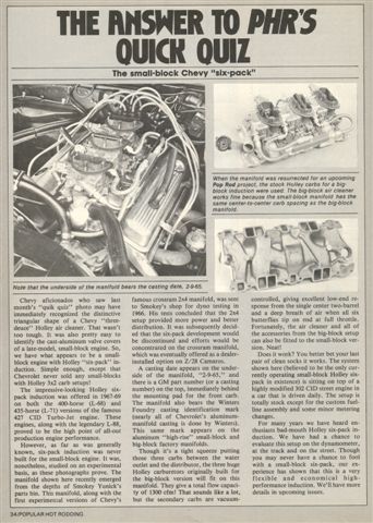

I know the 1967 Camaro originally was to be called a Cheetah but was changed to Camaro before being produced. My question is was there ever a 1967 Cheetah released I was talking to someone who claims 5 were sold to the public and he owns one of them. Is this possible some made it to the public as Cheetahs

The car I am talking about is called a Cheetah its supposed to be a very early almost proto type 67 Z28 called a Cheetah. The part which is confusing is he said it at one time had a 3x2 setup never thought they put that on a Z28

This is from Michael Lamm's book:

That makes much more sense than the Camaro line being named Cheetah. There was a scheduled RPO for a tri power engine but it was for a 396 that was cut before it was produced. I believe that the date it was removed was 10/66 but haven't been able to find the docs I have on it yet. I haven't come across one for a small block engine as of yet in my research.

There was also a small block GM engineering 3x2 set up that was being tested for trans-am use. It was dropped in favor of the 2x4's and the crossram. The small block 3x2's used 3 inline Holley carbs and had the same spacing as the Corvette big blocks. It could take the same big block air cleaner. There are several pictures of the Winters cast 3x2 manifold in one of the Smokey Yunick performance books.
