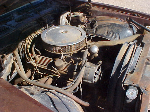

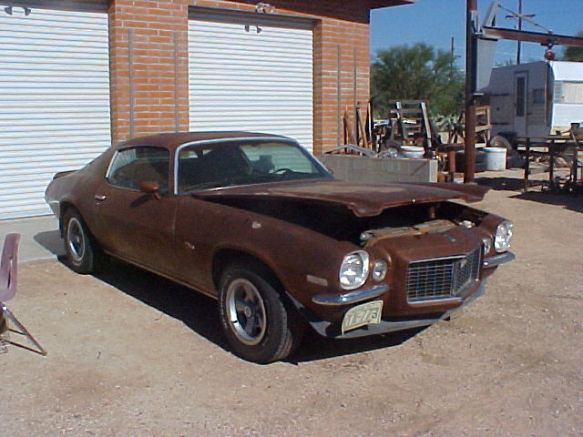

Hello, on a 70 Z Norwood car is the vin down by the oil filter like 69's are? I just purchased a barn find car with 66k on it that has sat since 78. The pad has CTB on it but no vin. Thanks, Larry.

Yes, normally, the VIN is down by the oil filter, although I have heard of several without the VIN. Is this an April build car by chance?

I have an LA built '70 Z and the pad has V0327CTB on it and the trim tag shows 04A but no vin as well (on the pad), could there be a Vin# on LA built cars down by the oil filter? I don't see one and interested possible buyers are asking about it.

Most of the LA built Camaro's I have seen have the VIN stamped on the pad, not down by the oil filter.

Here are some photos. I just bought the car from the second owner. He bought it in 73. He took it to a local speed shop and had the intake, carb, and headers put on for more hp. Then he had the strips taken off. He drove it until 78 then parked it. Its a non ps steering car, m22, RS. Still has the 772 fan, 837 alt, and pulleys. The floors are rock solid with rust issues on the pillars and front and rear glass. I put the wheels and tires on it to get it home. It had US mags. Still cleaning it out. Where would a build sheet be if they had one. Thanks, Larry.

The other side.

Exhaust
