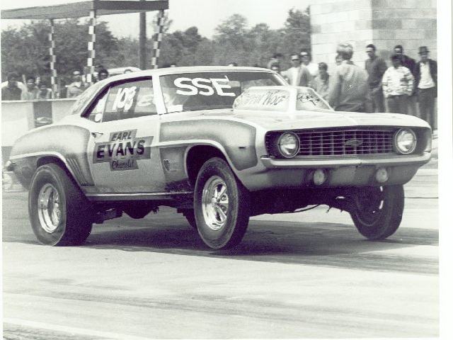

Where you "Earl Evans" guys at...Mark Hassett, or Bill S's buddy, or maybe they were in your neck of the woods, Steve F?
