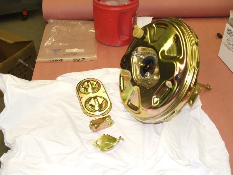

This first picture of the Booster and MC cover is Zink. Notice the shine. This was done by Steve Gregori in CA. Great job he does by the way.
These next shots are Cad I had done on the last car.
You can tell the finish is not as shiney. The Cad coating is far better for corrosion protection too.

I take boosters apart and have them plated and the inside of the booster that has the original plating still looks shiney just like the parts mike is showing, and they are 30 years old.
