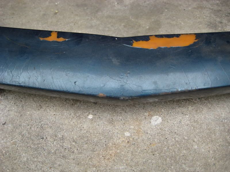

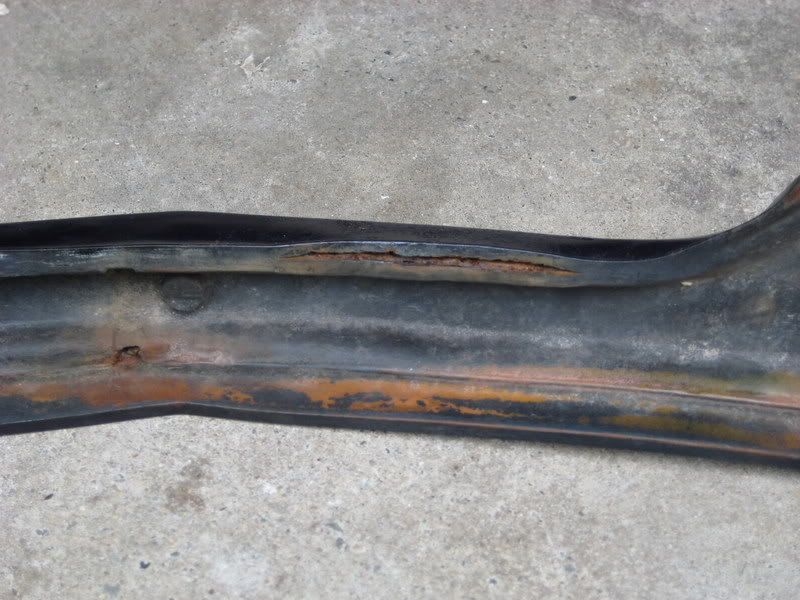

I have an Endura bumper that I was hoping could be restored - overall in good shape outside of a bad paint job and a split (3rd photo) on the bottom underside. Any thoughts on who could restore the bumper if it can be?

The VE3 bumper consists of a steel liner with rubber molded over it. The bumper is not watertight, the liner is not coated and rusts over time, splitting the rubber as seen in the photo. In my parts days we had a few so rusted they were limp. I have seen attempts made to repair them but they look repaired and continue to blister.

Grind all the paint off with 80 grit. I would then cut a flap that fully exposes the rusted area. Grind the rust away and prep it properly and then use the 2-part urethane rubber bumper repair stuff as a glue to hold the flap back down and clamp it in place.
I have done the same with Cuda rubber bumpers. They all had a habit of breaking off the sealed-in bumper bolts and you had to do similar surgery to replace the bolts.

What about soaking the bumper in Safest rust remover?

Unless you cut the access flaps, it wont be able to get to the rusty area. But its a good idea if it can reach the rust.
