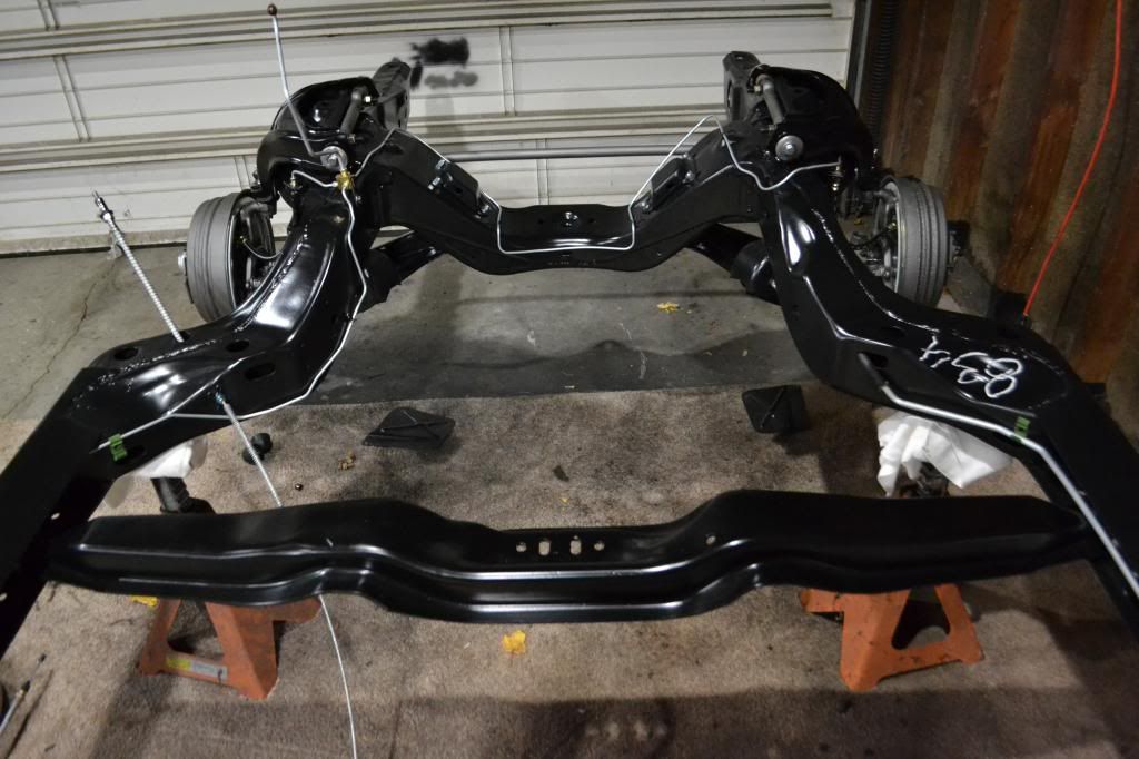

I ended up using SEM Trim black on my floor pan and sub-frame. I used it over PPG epoxy primer in gray. I couldn't be happier with the results. Here's how it came out.
-Dave
